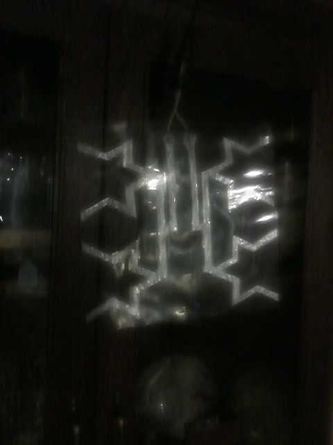

I bought a cheap 19" TV and needed an antenna. I ran into this design and found it cool enough to build.

Very interesting. How well did it work (relative to any other antenna you tried)?
It's hard to judge the size from your photo, how big is it?
I know some ham claims to have shown that ONLY a fractal antenna has some unique bandwidth properties, but what are you observations?? Do you have a reference link?? I might try building one too. What material did you use? What impedance do you match to (balun??) and transmission line?

The design was found on line and printed out. The elements are HD aluminum foil glued to the printed paper and cut out. Then I used two sheets of clear laminating plastic to contain the fragile foil elements. The balun is a 75 ohm, I think. It is attached to the foil through two holes punched into the laminating plastic. It works but I don't know if it is better than a random tangle of wire.
After I built this I thought about a dedicated trailer antenna right on the side of the camper wall. Thin wire or that copper foil used for window alarms. A nice 8 gang bow tie should fit on 4 feet.

Tomterrific wrote:The design was found on line and printed out. The elements are HD aluminum foil glued to the printed paper and cut out. Then I used two sheets of laminating paper to contain the fragile foil elements. The balun is a 75 ohm, I think. It is attached to the foil through two holes punched into the laminating plastic. It works but I don't know if it is better than a random tangle of wire.
After I built this I thought about a dedicated trailer antenna right on the side of the camper wall. Thin wire or that copper foil used for window alarms. A nice 8 gang bow tie should fit.
T
Sounds like a plan "Stan"
I want to see what you turn out. And get a test report.
I got to thinking it would be cool to use a rollable substrate (cloth. flexible thin plastic?) and glue flat elements to it. You could unroll it and use a pvc frame to hold it in. Should work good as long as you do not need to sit it up very high.
