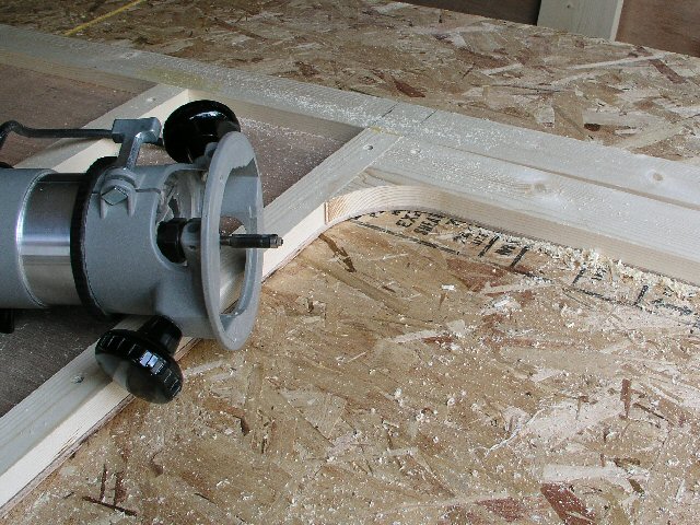

And for good measure I went out and weighed the floor assembly. I knew it would be the heaviest part of the teardrop body... sure is... it checks in at 93 lbs.
I also played around a little bit with the router, trying to learn from what Steve Fredrick did... I routed out the door... :D
