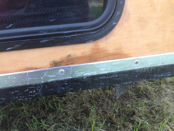

Hello all,
Brand new teardrop owner here with a problem - maybe big, maybe small - that I'd like to have a few people weigh in on.
After running in the rain for three hours and perhaps three days of light rain, the base of the plywood walls of my TDT are drawing in water from what must be the bottom edge. The trailer is less than 90 days old and has been run 95% in sunbelt states in excellent weather.
Does anyone have any opinion on how serious this problem is, and if it is to be fixed, any advice on how to proceed with repairs?
Thanks in advance for your advice!
teardroprescuist

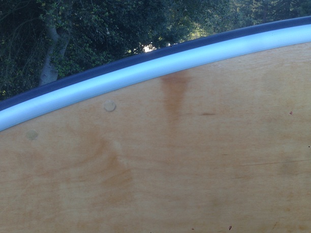

damage starting from the top on the starboard side
starboard side top.JPG (77.41 KiB) Viewed 1197 times

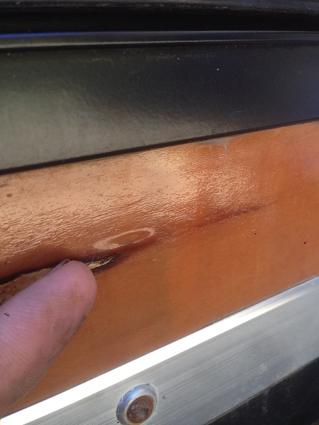

Starboard bottom closeup. Is this mold?
starboard mold.JPG (134.54 KiB) Viewed 1197 times

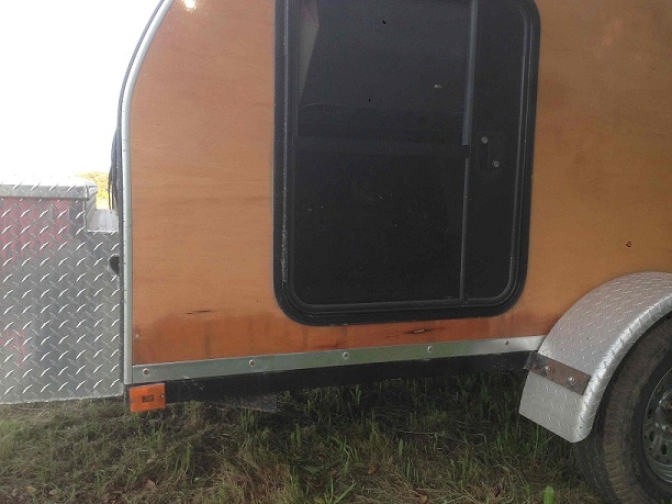

Bottom damage on starboard side
starboard bottom total1.jpg (94.13 KiB) Viewed 1197 times

If you don't fix it now you will have major problems in time. Caulk, seal, and paint the heck out of it. Remove as much trim as you can to get to all the hidden places. Also consider treating as much as possible with CPES before applying anything else.

Looks like nobody did the all important end grain sealing ... That needs to be done ...after everything is thoroughly dried ... :roll: If you have any water induced ripples in the skin , you can clamp a board to that while it Dries completely and that will help flatten it ..." The Mixture “ of 75% Mineral Spirits and 25% Polyurethane varnish does a great job of waterproofing plywood , and everything else .. As the Foamie people will attest . ;)
This all should have been done at the "factory” ... and is a warranty issue ... Good Luck !!!

The metal on your trailer seems to be layered up against the wood. Water/moisture will get behind this metal and stay there! Needs removed and slathered with caulk or at the very least caulked around each seam. Even a small gap between metal and wood will suck up water due to capillary action, it can even do this from the bottom. Let me add that there is ribbon and rope caulk that will ease the job.
Water runs down hill but it hangs at the bottom in heavy drips. Plywood is very vulnerable to this water hang as the end grain sheets suck up the water quickly. The thinned polyurethane will be sucked up into the dried end grain to block water intrusion.
Be aware, you are not the only owner who must deal with water. I thought I was safe but I just noticed a bad area about 30 minutes ago. Darn! Mine's in the bottom front so I think it is from water hang or possibly as weird as condensation between the ceiling and roof! :(

I've changed the images in the original post to reflect the starboard side, as there is also water ingress starting at the top it seems. This reply contains photos of the port side.
A further question; the manufacturer has offered to sand the sides and place aluminum sheeting over them (same material as the roof). Is this a sound strategy?

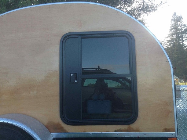

port side- fold in varnish
fold in varnish coat.JPG (83.31 KiB) Viewed 1195 times

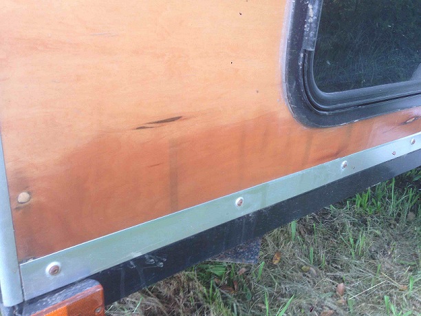

closeup of port-side damage
port bottom closeup1.jpg (112.68 KiB) Viewed 1195 times
bottom port side damage
port bottom total1.jpg (99.99 KiB) Viewed 1195 times

Adding aluminum without fixing the leaks would only leave you with “rot in a Can “ ... :frightened:

That is not a sound strategy. You must stop the wicking of water

I can almost guarantee (as others have said) that the water intrusion is coming in from the edges of the ply and has nothing to do with the coating. If it were the coating then the dark areas would be in wall areas and not near the edges. Only way to fix this is
1) remove stuff down to where you can see the edges, seal them and then replace or
2) remove stuff down to edges and if possible epoxy after allowing wet spots to dry completely.
Putting something over the top is just hiding the problem, not solving it.

All those wooden parts should really be removed and ALL the edges (and all Holes too ) treated THOROUGHLY with a waterproofing mixture ... Then the top edges/seams/corners where water can ( and will ) get in needs to be sealed with something substantial .... We experimented with Eternabond tape and found it quite durable ... and sealing ... A job that should have been done in the first place ... and yet another example of irresponsible trailer building ... of which there are too many examples to choose from ... :doh:
Ps , the bottom looks like "wood in a channel" , bound to hold water :roll: ... This area needs a a proper Drip Edge to transition water from ply side to ground , bypassing the trim altogether ...

I think you need to determine the cause of the wicking, and see how bad the damage is. The alluminum trim on the bottom might be the cause, if its keeps water from running away properly from the ends lf the ply. If the plywood is still good under that trim, and the bottom of the ply can be sealed effectively then the aluminum covering could be ok. I would ask that they also give you some sort of warranty around this repair. If the walls decay in the next couple years then you shouldn't be out a bunch of money.
