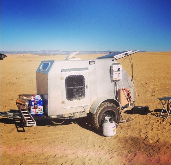

Postby Motomon » Fri Oct 21, 2016 5:52 pm
This was the setup on my old offroad teardrop. I stored it in a Pelican case with the shower nozzle and hoses. The pump was affixed under the trailer and the water came from carried jerry cans.
