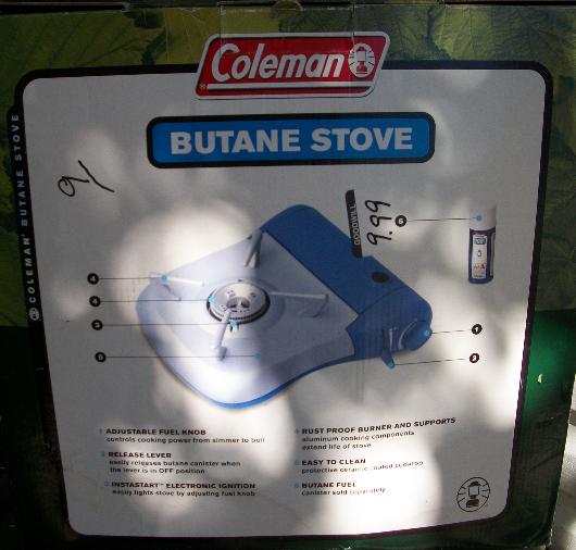

Postby bobhenry » Fri Jun 10, 2016 6:40 am
Damn just put a pinch of fresh ground roast between cheek and gum to tide you over !
But seriously if you want to boil water almost instantaneously here is the ticket......
OH ! By the way it was 1/2 off Saturday at Goodwill I got the burner for $5.00
couple it up with this little pot and 2 cups will jump to attention...
I was truly amazed at the butane burners hi heat capabilities. I was a little concerned with aluminum cookware
half expecting to melt the bottom out of the thin sauce pans.
