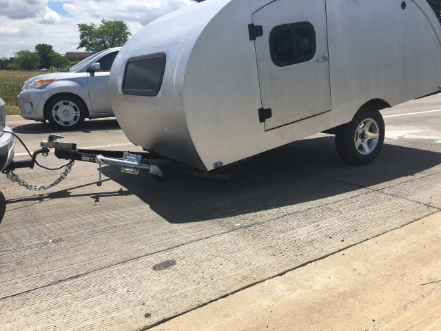

Postby mikeschn » Sat Jul 16, 2016 6:13 pm
So we were headed home from a long journey... We pulled off the highway to get some gas... All of a sudden we hear this loud thud behind us. Oh, this can't be good. It wasn't. I jumped out of the car to look, and here is what I saw...
oh sh**...

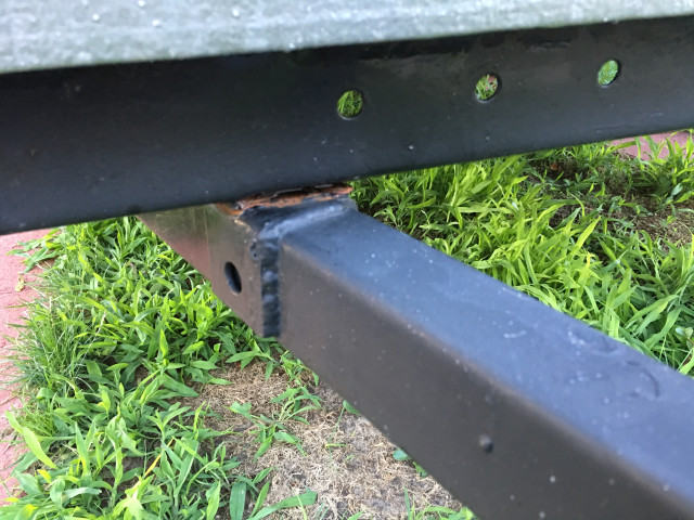

A quick view underneath reveals that the tongue welds have broken, and the dual redundant bolts are missing...

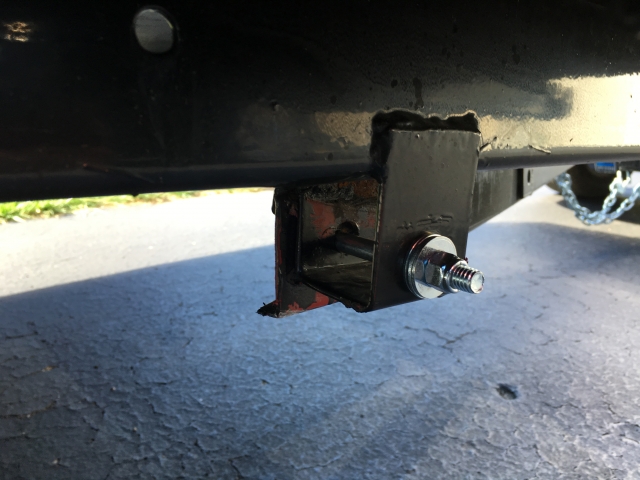

I made a mad dash to Menards, this time with the tow vehicle. I knew I had to get that teardrop off the exit ramp. So my plan was to grab a smaller bolt, with nuts washers, etc... so I could get it through the holes, and get the teardrop into the Menards parking lot...
I guessed that I could get a 1/4" diameter bolt through the holes... So I grabbed lots of 1/4" bolts, washers, nuts,
Got back to the exit ramp and proceeded to do the temporary repair...
Success, the bolts fit thru the hole. We are able to pull around the corner into a vacant lot... But there was no way those little toothpicks were going to get us home...

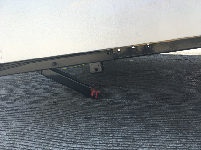

Postby mikeschn » Sat Jul 16, 2016 7:26 pm
It seems the front brackets are also pulling away from the frame...

okay got the bolts on... I seem to recall that the 3/8" bolts are like 4 times stronger than the 1/4" bolts. So I'm comfortable with that part of the frame.
The front brackets seem solid enough...

Sorry to hear of your event Mike. Glad to hear that no one got injured or hit it. I always get concerned on a trip when I first build a frame and drag it down the road. For what it's worth, If it were me, I'd make a sleeve/tube to fit in that opening where the bolt is exposed to stiffen up that piece so it won't tend to collapse once tightened. Doug

I have seen this happen with the bolt together frame trailers. Every time I have gotten involved with one. I spent quality time with a welder and did away with all the bolts.
The only bolts I use in trailer frame construction is for suspension parts.

I thought it was all welded up good. I guess it wasn't. I remember Kevin Hauser once saying that a good bolt is better than a bad weld, or something like that. He's right.
And when I build my teardrops, I always try to use dual redundant systems. I need to extended that concept to the chassis as well.
And this bracket, it needs to wrap around the top cross member...

:frightened: Bolts aren't the total problem. The welds didn't hold. I like the idea of using a quality welder; though, I would want back-up bolts holding the frame together as well.
mikeschn wrote:A quick view underneath reveals that the tongue welds have broken, and the dual redundant bolts are missing...

It is, although it's been stretched, welded, and apparently some of the bolts have been removed.
P.S. Can we conclude that the tongue has to handle the highest loads? and that we should pay extra attention to the tongue?
