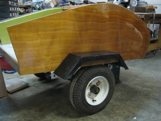

I'm building a Teardrop cargo trailer for the motorcycle. Making good progress but the HF fenders are heavy and not real stylish. Can anyone suggest a source of lightweight fenders that might look better on these 8" wheels.

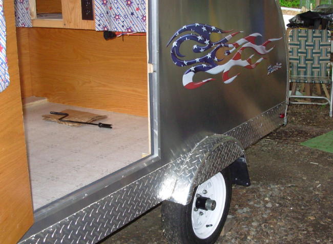

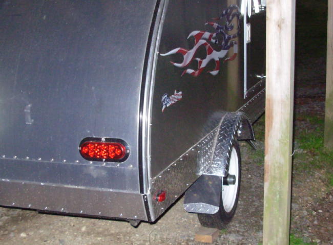

Appears your wheels are 'under' the trailer body. If so you may want to do something similar to what I did. I ordered a 'diamond tread' jeep (I think) fender from Northern Tool (they're not inexpensive :( ). After it arrived I measured the amount needed for a fender (for my 12" wheels), cut off the excess with metal cutting blade in my jigsaw, then split the fender in two lengthwise. I then ' V notched' each 'raw' edge, made a 'form' of high density plywood to fit the arc of the fender, bent down against the form, the 'tabs' made by notching, drilled 1/4" holes in 4 of the tabs, & bolted the 'new fenders' to my TD (think I used 1" long, 1/4" lag screws & lock washers). I later used the 'wheelwell cutouts' from the diamond tread trim to make 'skirts' for the fenders, but they looked pretty good before that...
