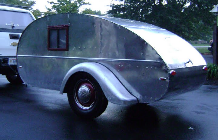

Postby mandymurrin » Sun Jan 08, 2017 9:36 pm
Thanks for all the help guys she finally got her new shoes. Image
