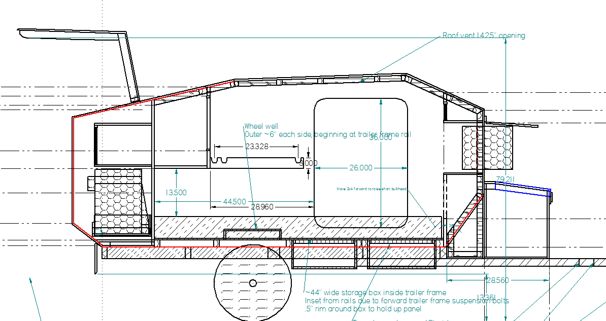

Going longer than 8' considerably expands your storage options.
Mine is 9.5', there are huge compartments over our feet, at the head of the bed and in the tongue box for gear, while still having a bunk for our toddler over our thighs. The long length also gives a full-height galley, which provides a lot of space, while 8' tears typically have your feet under some of the galley. There's also the under-bed storage where we throw a tool kit, leveling blocks, and other items that we rarely use but can't live without.
Facebook overview 20140321.png (48.7 KiB) Viewed 340 times
It also depends how much time, effort, and money you want to spend building the cabinetry, many people skip them to get camping faster.
