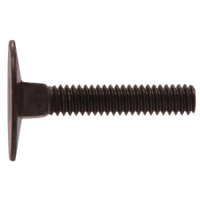

To replace bolt heads sticking up, you could try "elevator bolts"... Might even counter sink it a bit with "spade bit" if it compresses floor (foam) to much before becoming flush...
Might look at local sources first for the bolts...
Here is one source, but with internet access got to be 100 places to find what works best...
http://www.mutualscrew.com/Elevator-Bol ... 11955.html
To break the sheen of the poly and increase adhesion, scuff with sand paper, once it is a bit scuffed adhesion increases...

Great info! How do you tighten a carriage/elevator bolt when tightening into something a soft as 1/4" ply?
bosleybeebop
Posts: 23
Joined: Thu Jul 07, 2016 2:54 am
Re: Did I get myself into trouble?
Postby tony.latham » Thu Oct 27, 2016 11:12 am
bosleybeebop wrote:Great info! How do you tighten a carriage/elevator bolt when tightening into something a soft as 1/4" ply?
Prong washers. I assume that you've got something else between your plywood and your frame like 3/4" of pine or something?
Try ACE hardware.
Tony :thumbsup:
Also known as "torque washers"
