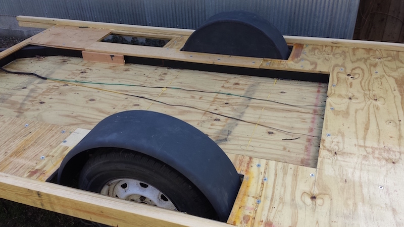

I had the same idea screwing the 3/4" plywood to the frame with Tek screws but I put a fender washer on the screw first. The treated plywood I used would compress easily with the screw, in fact a screw head could go all the way through it.
I had a tube of asphalt sealant laying around so I put that between the plywood and the frame.
I coated the under side of the plywood with aluminum/asphalt paint and the edges with titebond II before that, just to harden and help it resist any water penetration.
You can see the center section is screwed to the underside of the frame (took a cross member out) to give me a little more headroom in the areas where you stand.
This was an old camper chassis and has steel brackets welded on the rectangular frame that extend outwards. The extended parts are where cabinets, benches and bed are.
Oh yeah, the wooden rails that run along the outer sides give stiffness to the plywood there, but I found out the hard way that they were too close to the tires, which didn't have enough clearance to come off, so I had to make a cutout in that area, pita!
