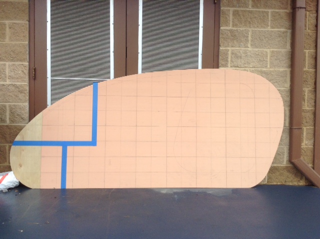

Here's my first attempt at the 9' template
I thought I had a good compromise with a 5'x9' design, but after reading the Teardrop Shop Manual I'm considering making it a 10 footer. Can anyone offer some advice or wisdom on which I should build?

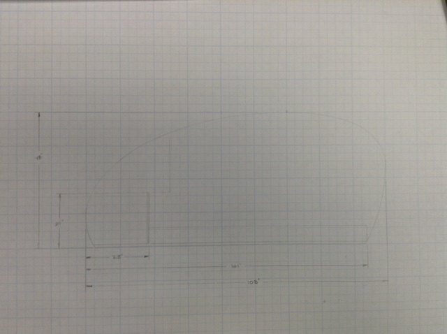

Modified 9' profile
by modifying the lower half, like the Grumman design, I gained 6"-8" in the bottom half of the galley. That should provide more space for a decent sized cooler. It might also make the build process a bit easier without those curves at the bottom of the wall where they join the floor. I'm thinking it might also make the hatch a bit easier to build. The top half is borrowed from the Modernaire, and the bottom from the Grumman 2.

Go with a 10' build. You'd be surprised how much more you can fit into that last 12"!!!
You could eliminate the radii on the bottom, makes it easier to design!
Go With 10 Feet
Postby Dusty Mark » Tue Dec 06, 2016 10:07 pm
You'll already be scarfing plywood to make side panels longer than 8', so it wouldn't be extra work or materials to go to 10'. The proportions remain pleasant at 10' and it does give you more floor plan/storage options...

It looks like you are losing 8" with that rolled-under nose. 8" in a teardrop is a lot of lost room. Most folks end up putting a tongue box anyway....
I really like our (flatfront) 5x10. Gives us the full-length queen bed plus a few more inches in front of the cooler for dry goods and extra propane bottles plus storage under the headboard.

i started my design with rounded under front and back. eventually I changed my plans to a benroy style because of the large increase in space that it gives you having those flat front and back walls. I needed that space though because of some claustrophobia coupled with building a bunk for the kiddo.
it is all really personal preference. just figure out how much space you need before you build. you could split the difference and keep the curved under shape but make it 10 ft to give you more space...

I applaud your dedication to minimalism. I have to say, though, that stretching the body from 9' to 10' doesn't exactly turn it into a Jayco :p
You'll likely waste less material by going to 10' rather than 9'. Also, deeper kitchen lower cabinets allow you to easily store coolers, pans, cooktop stoves, and other kitchenware that is stupidly irritating to store in the 16-inch-deep cabinets typical of 8-9' teardrops.
Also, unless you want a flat front, 10' sidewalls are much more forgiving of curvilinear profiles. There's more room to play with headroom and so forth. Also, lots of people like to have some cabinets or shelving in the front. That can be hard to squeeze into an 8' cabin.
Then again, 8' cabins are cheap, easy, strong and lightweight. So you can't go wrong either way!
