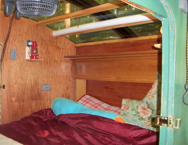

Little if any venting and a "ceiling fan" to force that hot air off the ceiling and wash it down the sidewalls with a fan pointed upward.
(Yes it is a see thru (very uninsulated) roof )
You haven't seen a thing until you lay snuggled down in your warm bed and watch giant snowflakes explode on your lexan roof.
A good zero sleeping bag can be your best friend. If you want to share body heat :) You can unzip them and sleep on one and cover with the other.

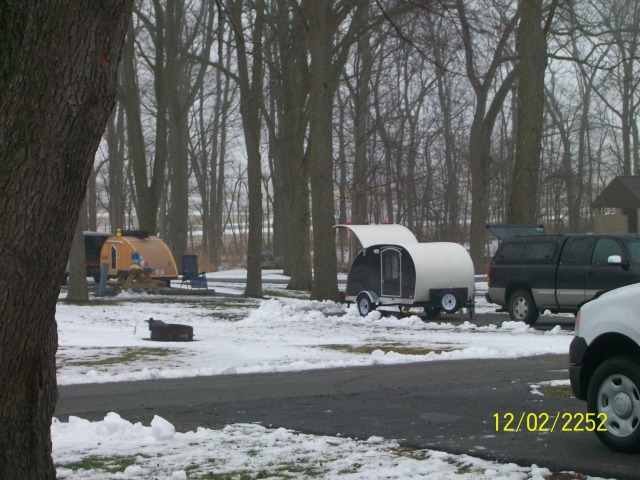

Here is a few shots of a couple of our Indiana Shivarees
My barn is 5x10 by 5-6 tall and even with an un-insulated rear door we are quite comfortable with a small ceramic heater much like yours !
