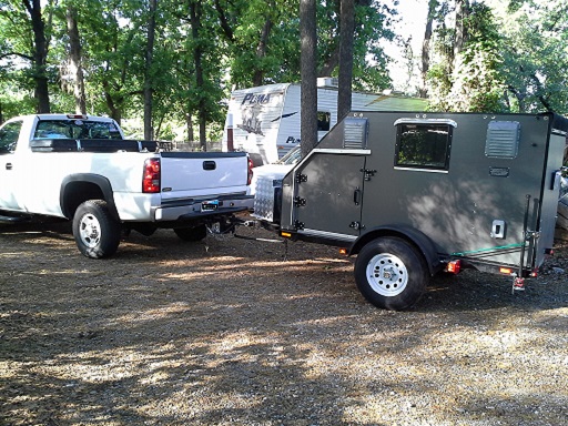

* My original concept was to make it simple, strong,and with a 45 degree front slope for aerodynamics (since I couldn't bend 3/4" ply). The Kammback was also in the original plan, though I used a semi-rigid piece of conveyor belting to create the Kamm effect. Aerodynamics was always a factor of the design, because I had intended it to be towed in the air shadow of either my wife's Cobalt (@55.5 inches roof height, and roughly 40 inches at the trunk), or my HHR Panel (@63 inches roof height), while the trailer's front began sloping back @ 40 inches, rising to the roof @70).
* But it ended up way too heavy to be towed by either (1600+ lbs, way over their tow limits of 1000 lbs each). Ended up towing with my HD truck, so the aero is not a factor, nor the weight. The trailer doesn't affect mpg at all; truck doesn't even notice it there. That's ok, though, since I started out wanting it to be semi-off-road capable, despite the Cobalt or HHR not beng capable of off-roading in the least, so weight be damned, I was able to keep adding more features (+weight) and a stronger undercarriage (3500lb axle, heavy-duty springs) to make it more off-road capable.
