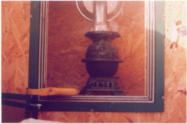

Postby KennethW » Wed Dec 21, 2016 10:29 pm
138445 here is one way to put a fully vented heater into a wiley window. That is a big stainless steel dog dish glued to cement board with high temp silicon glue.

Postby QueticoBill » Thu Dec 22, 2016 8:22 am
KennethW wrote:138445 here is one way to put a fully vented heater into a wiley window. That is a big stainless steel dog dish glued to cement board with high temp silicon glue.
Would love to see a picture of the heater outside to get an idea of how that worked.
