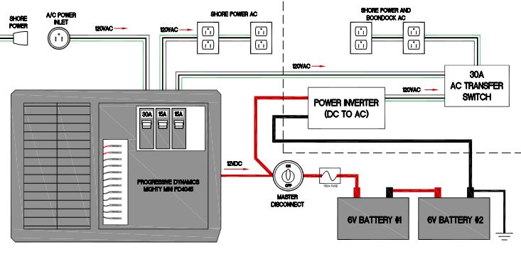

Postby absolutsnwbrdr » Wed Apr 26, 2017 9:09 am
Hey guys, I'm working on a wiring diagram that is based on a PD4045, and will include an inverter and automatic transfer switch to provide AC power to the system when not plugged into shore power. I keep getting stuck in a loop though. Doesn't the automatic transfer switch only alternate either from shore power to inverter power?
How do I keep inverter output (120VAC) from automatically driving the PD4045 charging circuit, generating 12V power to the batteries, which then powers the inverter input?
It seems like I need a DC disconnect switch on the 12V primary wire between the PD4045 and the Master Disconnect. But then its not all automatic. :thinking:

Postby lfhoward » Sun Apr 30, 2017 8:09 pm
Hi Zach,
Couldn't you have the PD4045 branch off of the main 120VAC power line upstream of the transfer switch? When plugged into shore power, the PD would be powered by AC, but not when boondocking. What is missing in the diagram is a line from the Transfer Switch to some 120VAC 3 prong outlets. You could run your AC gadgets from those, regardless of where the 120VAC power is coming from (shore or inverter).

Postby absolutsnwbrdr » Mon May 01, 2017 3:17 pm

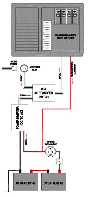

In the previous diagram I was trying to feed the PD4045 from the inverter so that all 120VAC circuits protected by the PD4045 would be hot on inverter power. But with the PD4045 hot on inverter power, then that cycle starts.
I had given a little thought to the configuration you mention (I think). When boondocking, I think that leaves me with only one branch circuit from the PD4045 that uses inverter power. All other circuits from the PD4045 will be dead.
When on shore power, all circuits would be hot and protected, by way of PD4045 and the transfer switch.
If that's the way it has to be, then it is what it is. Ideally, one would like to have all circuits able to be used while on inverter power.

Postby aggie79 » Mon May 01, 2017 3:29 pm
Zach,
How about the use of a relay that "makes" and "breaks" the DC battery charge line between the convertor and batteries? If the relay detects 120 VAC power between the shore power inlet and transfer switch, then it "makes" the connection. If there is no shore power then it disconnects the hot DC line to the batteries.
Re: power Inverter question
Postby absolutsnwbrdr » Tue May 02, 2017 8:13 am
Are you referring to my first diagram or the second one?
I wonder if that would prevent the PD4045 from providing power to all the 12V stuff. Some people have claimed that the power center will not produce 12V without sensing a battery. I cant confirm that though.
