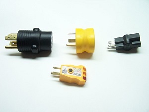

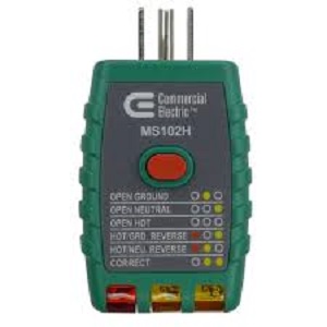

I use the 120v outlet shorepower for my A/C assembly (the A/C unit+chassis cooling casefan+inline exhaust fan), and possibly my 400 watt inverter (for battery charging) while inside the trailer. Total amperage is never above 12 amps, so the 14 gauge extension cord (rated for 15 amps) I use for connecting to the pedestal is sufficient. However, I also carry a 12 gauge extension, just in case I have to use one of the other outlets (30 or 50 amps) if the 120v plug-in tests bad (I use a GFCI outlet tester);
gfci outlet tester.jpg (16.95 KiB) Viewed 405 times
in that case, I have adapters.
adapters for input line.jpg (13.36 KiB) Viewed 405 times
I run the extension cord thru a sealed access port to a GFCI protected outlet base in the trailer, then to a surge protector,http://www.tnttt.com/viewtopic.php?f=30&t=60587#p1088735 then to the 120v outlet plugs in the cabin (for A/C and inverter). I haven't needed the larger gauge adapters or extension yet, but I have them ready.
