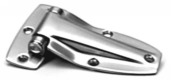

One example is what Grant used to call the "better-than-hurricane-hinge". I've used the Steve Frederick hatch design, and want a zero offset hinge. Has anyone used the hinge sold here http://teardroptrailerparts.com/Hinges_ ... _Trim.html ? Is this the same hinge that Grant was selling? TC Teardrops sells a nice hinge, but it has an offset as do all of the other vendors that I have found so far.

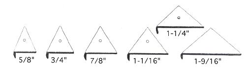

Also, at http://www.teardrops.net/teardroptrailerparts.html , there was a variety of widths of aluminum trim available. It seems that other vendors sell one size only. Has anyone located a vendor who sell a wider range of sizes for this trim? Example from teardrops.net

Postby QueticoBill » Thu Aug 10, 2017 12:43 pm
I've been eyeing a hinge like that - both at etrailer and on ebay. Think its same? Do you feel it will last?
https://www.etrailer.com/Enclosed-Trail ... 83700.html
http://www.ebay.com/itm/1-NEW-Trailer-o ... pM&vxp=mtr

Postby wingloader » Thu Aug 10, 2017 12:53 pm
I bought four of those hinges on eBay from this seller.
http://www.ebay.com/usr/1stop_rvshop?_t ... 2749.l2754
http://www.ebay.com/itm/Chrome-Plated-T ... 2749.l2648
Shipping was unbelievably fast. They are very solid hinges with good chrome plating. I'm sure they will last a very long time. You can get really nice beveled head Phillips stainless steel bolts at Lowe's for these and they fit perfectly.

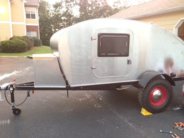

I found the perfect hinges from Austin Hardware.
http://austinhardware.com/AH3.aspx
Hinge
They are shorter, and fit my doors perfectly without interfering with the window. They seem to be built well. They come in left and right hand.
Hinge 2
I tried to use stainless steel hardware wherever possible to minimize the chance of corrosion. Besides the trailer frame, a few staples from an air nailer in the roof, and the gas springs, I don't think I have any steel in my TD at all.
