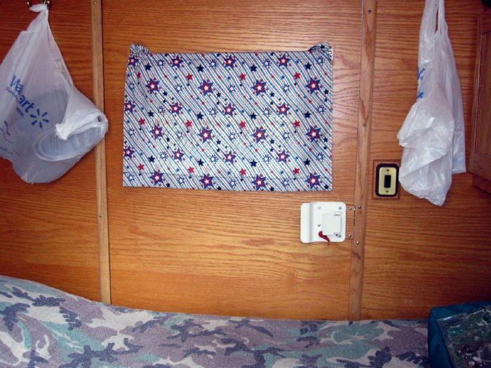

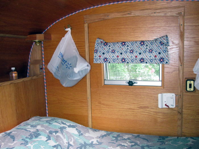

I built our TD in 2006. It is 50" wide by 114" long & has a cabin height of around 48" give or take a couple, outside measure. Sleeping compartment is approx 57" wide by 77" long with a storage compartment in the 'curve' at front & cabinets approx 15" over our feet that reach to the ceiling. I ordered & installed a Fantastic fan (Have no idea what model it is, 3 speed, reversible, DC powered). Our walls are framed with white pine/spruce ripped from 2x4s, (1/4" oak ply inner layer, 1/8" luan outer, covered with 0.040" aluminum, insulated with 3/4" blue or pink styrofoam in walls/doors, & floor, 1 1/2" in the roof) & the doors (2 each, 1 per side) are constructed identically. I located, ordered, & installed a 12"x18" 'crank-out' window in each door. My wife sewed double-layer curtains for each window. I have a Group 27 battery in the galley to provide 12vdc power for the lights, stereo, & the fantastic fan. We often have hot, muggy nights (& days) here in 'the south' & we've camped from Florida up the Atlantic coast & to the Pacific Northwest, & south to California so we've experienced a variety of weather conditions in our travels. If it is too hot/muggy to sleep comfortably we open the door windows about an inch or so & turn the fantastic fan on low, reverse flow, & it draws air in the windows, the curtains direct the air downward onto sleepers & within minutes we are comfortable. Many nights I've had to turn the fan off around 1-2 O'clock in the morning because it gets too cool. I also ordered a 2500BTU Pet Cool air conditioner & 'plumbed' the TD for it. We've used it maybe 3-4 times when camping in 'the south' in July when temps sometimes get unbearable. It requires115vac hook-ups but if it's that hot we make sure we have power wherever we camp (usually Corps of Engineer lakes). I can't give you a range of temps we're comfortable at but I've camped in southern Illinois in November in 18 degree temperatures & been perfectly comfortable in a good sleeping bag. I used to have a small HF 12vdc heater defroster that I'd plug in & turn on 10-15min before bedtime & when the alarm went off in the morning, it would warm the cabin up enough that I could dress/undress & get into/out of bed in comfort. I'm sure it drew quite a few amps but I never measured it & I've used it for 3-4 nights & mornings successively without killing my battery. The switch finally fried so I haven't used it for quite a while. The fantastic fan has done an outstanding job for us throughout our 10yrs & 30K miles. I think that it combined with the door windows have enabled us to camp in truly miserable weather in relative comfort...
