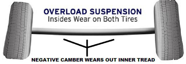

  • It looks like too much negative camber to me. I had the same excessive tire wear on my carhauler tandem axle trailer, after a very heavy front loader bent my rear axle. I had some, but less wear of the same type, on my TTT's original axle, after I overloaded it (by 75%). I replaced both axles on the carhauler, and later, the TTT's axle, with no-camber 3500lb axles. This is how a badly negative-cambered axle wears out inner treads on tires.
    NEGATIVE CAMBER.png (114.15 KiB) Viewed 3112 times
    smooth, but worn inner treads

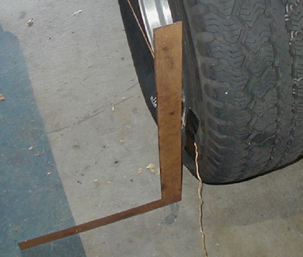

  • I prefer no-camber axles, because it is a simple matter to check their straightness/camber with an angle ruler, used for framing. Just load your trailer, torque your lug nuts, inflate your tires properly, and just stand the ruler up next to the tire. both the sidewall above and below the center should always touch evenly. You can also easily check the squareness (relative to the frame) of your axle at this time, by running a string from the same point on each tire, to a corresponding point on the frame (in front, or to a point marked on the ground, directly below).
    camber check with angle.JPG (82.45 KiB) Viewed 3112 times
    simple angle square ruler to check camber
  • I just looked up the Silver Shadow. It seems that they come with torsion axles, so I'm not sure if they come cambered or not; anyway, the checking procedure to assess your camber should be the same.
  • Negative camber (in excess) can be reduced by lightening the load, or by bending the center of the axle tube upwards (in the middle), if possible. Once again, it might be different for a torsion axle, I don't know. A straight replacement might probably be the best fix, in either case.
