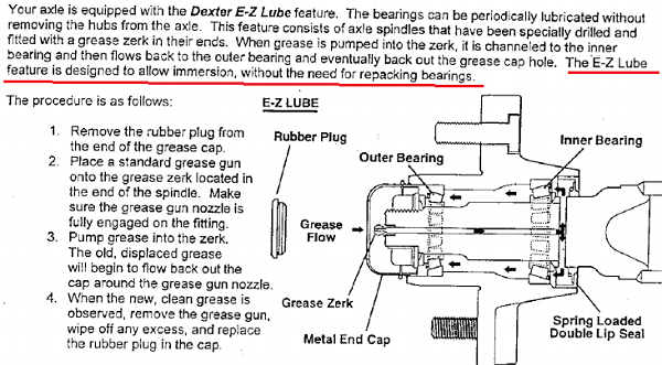

  • Overgreasing is as bad as undergreasing (but not no-greasing), in my experience, but different circumstances accentuate the problems. I'd rather use a higher grade grease, with better heat capability, if I were to knowingly use a worn bearing or a low-grade bearing, just for the added protection I'd need 'til I could replace it with better quality. For instance, though my front wheel bearings on my old '69 C-10 pickup were good quality, they were also at least ten years old, and had questionable maintenance before I bought the truck. I saw no damage, nor could I detect any bluing from heat, but since I was daily-driving this truck 600 miles a week in DFW traffic, I was having to re-do the brakes every month (4-wheel drums, aged master cylinder, panic stops). I used the best bearing grease I could find (I tried them all). No problems. But I had a cheapskate friend, with another old drum-braked Chevy truck, who drove a less demanding route, on weekends only, lock up his front left wheel, using some cheap old grease he had for years. Quality pays for itself.
  • I never used Bearing Buddies, not having a boat, but my friends that did have boats, all used BBs. One or two failed to check them, thinking that they were permanent fixes, and paid the price. I used regular grease caps on my trailers, like on my cars, and checked them at regular intervals, so I had no problems. But, I'm getting old, and looking for easier ways to do things, so when I bought my TTT a new axle for an upgrade, I opted for the EZ-Lube bearing/spindle, so greasing would be simple, and not require the usual procedures. And, though I haven't yet, I intend to do some light off-roading with it, so the added water protection of the EZ-Lube is desirable. It wasn't marketed as a Bearing Buddy competitor, but it shares some properties of water-resistance with it, so it was good enough for me to try. If I were to have a boat trailer, maybe not. With either brand, the greasing procedure is simplified, though a bearing check (for looseness or wobble) needs to be done, even on lightweight TDs and TTTs.
    Dexter EZ-Lube, with water-resistant properties
    bearing buddy.PNG (174.42 KiB) Viewed 1124 times
    Bearing Buddy, a boater's friend

Two thumbs up on the Dexter EZ Lube axles which came with my trailer.
I lube more frequently with it since its very easy and clean.
When the time comes for new bearings I will go with Dexter on my rig.
Since its a submersible axel and you -flush out the old grease there is there is no chance to pump in too much or too little grease. Just flush till you see clean grease. Then wipe. There must be a joke here but I am not going there.
