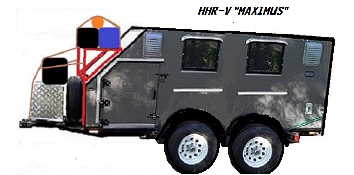

  • I built a 4'x8' TTT because it was the same size as the "originals" were, and the standard size of the plywood sheets I was planning to use. Plus, it was never intended for use by two people at a time, just one, but two could use it if needed (thus, two doors). I crammed in so many features and extra gear, that I soon overfilled that 4'x8' footprint (made from a 50"x 60" junk frame, by adding 12" on the front, and 24" on the rear), so I have started to add racks to hold the overflow items.
  • 148333148331 overflow items on a new front rack
  • My neighbor just bought a nice 4'x12' utility trailer, a"steal" for $250, which needed some repairs. I helped him add planking, welded up the expanded metal sides and ramp, and tried to buy it from him, as it was perfect for a project I have had in mind for a long time...extending my squareback trailer's cabin size, to accommodate everything I can't fit into it now. So, here is the new, improved HHR-v trailer:
    Bruder-style HHRv maximus.jpg (65.89 KiB) Viewed 1109 times
    finally, I have some interior room

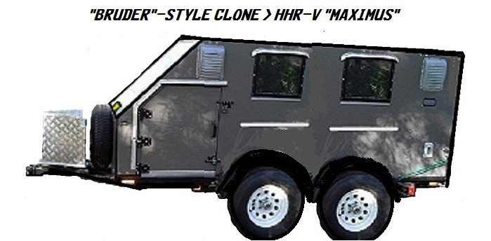

  • Just kidding, his utility trailer isn't for sale, and is only a single axle, but this is what I envisioned doing with it, if I could buy it from him. I would've removed the cabin off of mine, cut it just behind the doors, inserted a 3 foot center section, and go with tandem axles underneath. My original frame would've been converted to a utility/off-road military-style trailer, which are in great demand on Expedition Portal, for use by rooftop tenters.
  • I don't know how much it would've weighed after the conversion, but 2 x 2000 lb axles would've worked (it already has one). If I went that route, I'm sure I would eventually overfill the interior spaces (even with 46.5 extra cubic feet of space inside), so I would probably need to leave the front rack on it.
    enlarged HHRv maximus.jpg (64.87 KiB) Viewed 1109 times
    the rack would be needed, sooner or later
  • Rear storage would be kept the same, but a self-contained porta-potty would fit inside the enlarged cabin, and a wall-mounted jump seat (for changing clothes, etc.) also. I would still use the twin mattress size, since larger isn't needed, but moved forward, with the new features placed at the rear. In my dreams....
148331

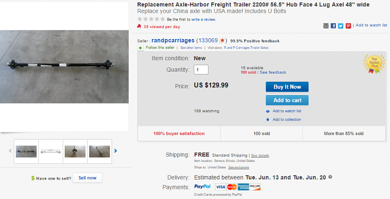

  • The first thing I changed on my trailer was the tire/wheel/hub size, from 8" to 14", because the smaller tires were not capable of doing what I intended the trailer for, travelling at high highway speeds (the smaller tires have to revolve much faster than larger diameter tires, thus more heat/wear on the bearings), and eventually going off the pavement (un-improved dirt roads, etc.).
  • I chose 14" tire size, mainly because I had extras for my wife's trailer, and it was a large enough tire to look right on the design I had in mind. Also, it is a common size for many trailers, and I could find tires anywhere (after I switched from ST to LT tires, I found that selection much smaller- 15" would've been a better choice-). I replaced the original 4-lug hubs with 5-lug hubs, using larger bearings on the original spindles, but had to use spacer/adapters to move the wider section width tires away from the frame. Eventually, using the original axle (1.25" square tube, of unknown weight capability)became worrisome, as the trailer weight grew over 1500 lbs, and when a spring hanger tore loose, I replaced all the suspension parts with a Dexter 3500 lb axle (w/brakes), and heavier-duty parts. I should've done that initially, but I was hoping that the small axle would be strong enough, 'til I could afford a more capable axle set-up (my initial build was low-budget/no-budget).
  • I started with the remains of a junk trailer I had, building upon it as I went, so I never had a Harbor Freight or Northern Tool trailer to deal with. Though many using these Chinese trailers have had no trouble with their bearings and tires, others have. les45 didn't have trouble with his, but opted for the better quality/ride of larger 13" tires. Others have had trouble with the bearings, and even when they re-lube them with quality grease, many order and carry spare bearings with them on trips.
  • When I was planning to replace my original axle, before I decided the 3500 lb axle was the best choice for me, I shopped around and found many capable 2000-2200 lb axles, made in the USA, which were available locally, or online, fully assembled or axle/spindle/spring perch only (add your own bearings and hubs), but when I decided to get brakes and EZ-Lube hubs from Dexter, I gave them my specs and they built it for me. But, for a replacement for a Chinese axle (HF or NT trailer), I found this fully assembled Dexter axle (2200 lb) online, as a "direct replacement" option. They offer 4 or 5 lug hubs, and will even modify the spring perch location if asked to. The offer comes from a reputable known seller on E-bay, so if I had a Chinese trailer, and if the axle had been a little wider (at 56.5" hub face-hub face, it was a few inches less than what I needed-63.75-, I would've snapped it up at $130, if I had seen it at the time http://www.ebay.com/itm/Replacement-Axle-Harbor-Freight-Trailer-2200-56-5-Hub-Face-4-Lug-Axel-48-wide-/351904092221?hash=item51ef1e503d:g:myIAAOSwcUBYJ4B1&vxp=mtr
    Dexter replacement for Chinese axles (4 or 5 lug hubs available).PNG (249.19 KiB) Viewed 984 times
    made in USA; Dexter quality replacement for Chinese axles
