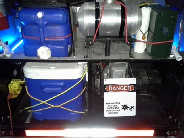

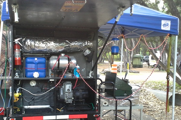

  • My A/C and ducting system, and the generator and extended-run fuel system take the lion's share of all the space. I do have my Coleman stove (and fuel) tucked into a corner (the Northstar lantern hiding behind the fuel tank), my perishable foods are kept cool (somewhat, see my "cooler inside a cooler thread" at http://www.tnttt.com/viewtopic.php?f=2&t=68543 for details), and I insert one of my Aquatainers in a receptacle under the A/C unit; those are my concessions to the typical galley contents.
  • All my canned foods, and my utensils, plates, pots & pans, and my new cast iron gear, are carried separately inside a Tractor Supply storage box, which I usually keep in the truck bed, but will now carry to camp on top of my tongue box (securely strapped to it, as pictured in my signature photo/drawing), then set up next to my stove on break-down tables I carry, under my canopy, in the sitting area. If I am bringing chips, or bagged food items, I keep them in the truck, until needed. I stash paper towels, as well as kitchen wipes, in galley, cabin, and truck, because I use them frequently everywhere.

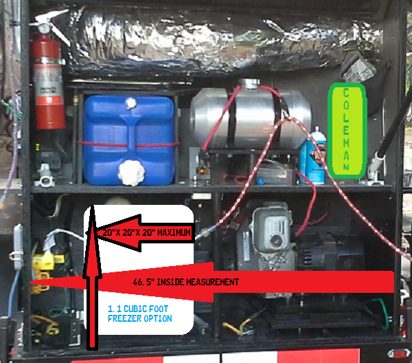

  • I may make a change to the galley in the future, if my cooler situation doesn't improve, and add a 1.1 cubic foot mini-freezer in the spot where I currently keep the Cube cooler, if I decide to stay on a campsite for 4 or more days (three days seems to be the max for my ice-type coolers, to date).
    galley set up.jpg (132.99 KiB) Viewed 788 times
    cooking gear set-up on sheltered side-table
    rear freezer option.png (525.53 KiB) Viewed 788 times
    white box represents future freezer???
