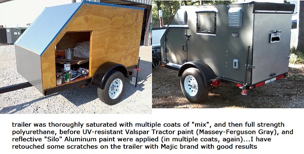

  • Though I've only used Luan as the top layer of my trailer's flooring (1/2" birch plywood topped with 1/4" Luan, glued with Titebond 2 and screwed together around the perimeter), I coated it with multiple coats of Minwax polyurethane. I use commercial rubber-backed carpet/matting over the floor, so wear is not an issue, but I've had standing water (due to an unclosed door issue) on the Luan floor for 36 hours, without any damage or delamination, so I think that a good coat of poly will prevent water intrusion.
  • Though there is no Luan on my TTT's exterior, perhaps you could use the same paint/coating procedure that I've used, to "waterproof" your wood. I used the "mix", of polyurethane and paint thinner, to penetrate thru the outer layers of plywood (and Luan), followed by more coats of mix, then pure poly. Then, I used Valspar alkyd enamel tractor paint as my primary paint, and Valspar Heavy-Duty reflective "silo: paint on any surface that could face upwards (the front roof slope, the roof, and the hatch door). I bought the Valspar brand which was marketed at Tractor Supply, at that time, and it has worked great since 2012. I recommend the Valspar brand highly, but now Tractor Supply carries the Majic brand, which doesn't specific for use on wood, though I've used it for touch-ups over the Valspar, with success.
  • If I were to paint a Luan-covered trailer, like yours, I would first use the poly "mix" and the tractor and "silo" paints again...the key being that the poly mix penetrates and protects the Luan, the pure poly finishing coat gives a good surface for the solvent-base of the UV-resistant paints to follow, and the tractor and "silo" paints are meant for constant weather-exposure, so they have proven to be durable, at least to me.
  • I'm pleased with my paint lasting without any problems so far, except scratches that I've made during work in my crowded/cramped garage, and was fully expecting some delamination (especially on the plywood edges), but there's been none. True, the trailer is stored in my garage, for about 95% of the time, but no problems yet. My alternative choice for coatings were a bedliner type of material, to completely cover all surfaces with an impenetrable coating, but my favorite choice (Durabak) is about $130 per gallon, so I'm glad my trailer is holding up so well, as-is. Good luck, and try this procedure if you feel it'll work for you, as it has for me.

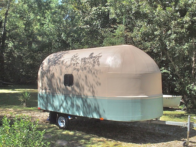

We've been using a good exterior Latex Exterior house paint .. My Trailer has sat outside for almost ten years now , the paint just needs a good washing now and then .... May be doing a re-paint soon ... Just because we're tired of the colors and have to do some very minor repairs .
FS .JPG (168.71 KiB) Viewed 887 times
