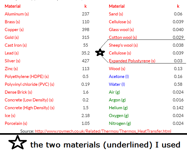

  • I've experimented with a.) mylar-faced reflective denim insulation (Ultratouch) http://www.tnttt.com/viewtopic.php?f=2&t=61135, and b.)expanded polystyrene foam insulation (Owens Corning Foamular) http://www.tnttt.com/viewtopic.php?f=2&t=68543&hilit=failed+experiment, with mixed results. High-end coolers, like Yeti, have thick insulation as their secret to keep cool over prolonged periods, Using that principle, I chose to increase the thickness of insulation already provided by two different coolers (actually three, as it turned out) by adding an outer insulating layer (or more). I chose the best materials I had, which are listed with low coefficients of heat transfer, cotton wool (chopped denim is similar), and expanded polystyrene (rigid, pink foam).
    coefficient of heat transfer (k).PNG (72.39 KiB) Viewed 802 times
    the best common insulators I had

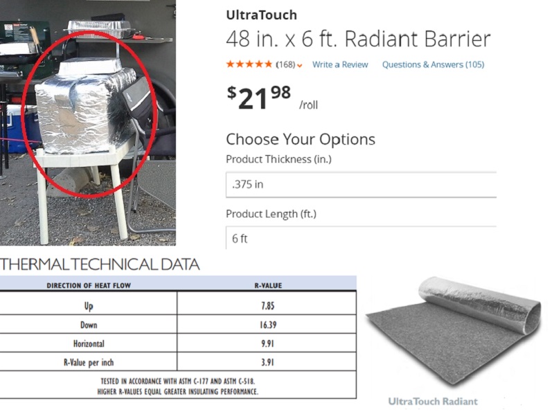

  • a.) Sure, wrapping a cooler with a reflective radiant barrier will reflect some heat away from a cooler, and dense insulation tries to keep the cold inside, but unless you encase the cooler in several inches of insulation, it only slows it down a little. I used one layer of the Ultratouch all around my cooler (Coleman Extreme), and even had it sitting on an extra layer of insulation on a raised storage shelf/table that would further separate it from heat transfer from below. Even under my canopy, the experiment wasn't successful, even though the cooler remained closed for the entire duration of the test. Ambient temperatures were too great to overcome, as usual in N. Texas.
    Ultratouch experiment.jpg (117.95 KiB) Viewed 802 times
    single thickness of insulation not enough

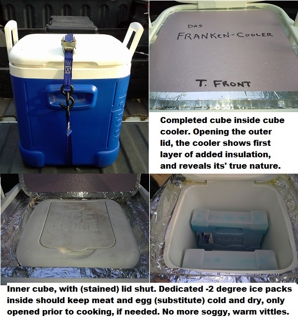

  • b.) My cooler in a cooler experiment wasn;t tested in the outdoors, but in a constant temperature inside. Using two inches of pink foam, Great Stuff spray foam and foil tape to seal voids, and with EPDM foam seals, it fared better, but not up to the (claimed) standards of the high-end Yeti-type coolers.
    second cooler experiment.jpg (168.19 KiB) Viewed 802 times
    better results, but will more insulation help?
  • Perhaps, combining materials used in both prior cooler experiments, a + b, might be the ticket for my goal of keeping just a small amount of perishables cool enough for a 3-4 day trip, Otherwise, I'll have to go with high-end coolers, or add refrigeration to my trailer, both of which will be expensive. P.S. I didn't try Reflectix, because the only product I had was their double-reflective "bubble" wrap. I use it under my roof as insulation, but to get effectiveness from it, I should have to wrap several layers of it to achieve the insulation of the other materials I sourced locally, or had on hand.
