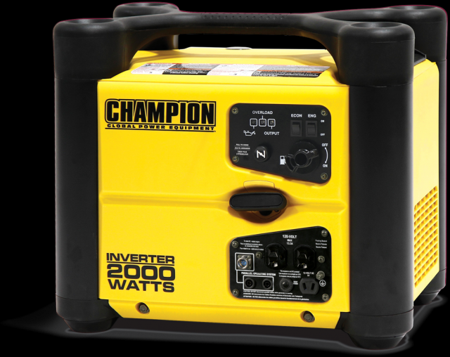

Postby Goatdog » Fri Aug 11, 2017 11:08 pm
I've had that Champion since 2009. Never a glitch

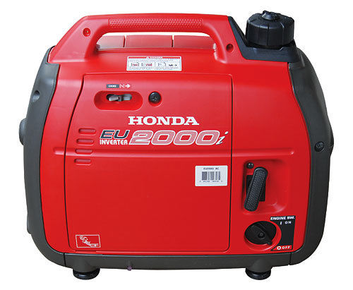

Postby dmb90260 » Sat Aug 12, 2017 7:40 am
I have a Honda 2000 which I used for the teardrop and now occasionally for my 16 ft vintage trailer. It sets the standard for being quiet. I have been to many dog shows and if there is no shore power the Honda is the generator used most often.

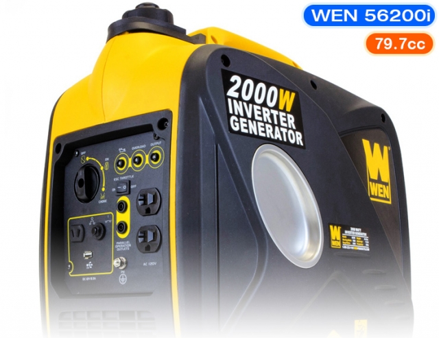

Postby DWT77 » Sun Aug 13, 2017 7:11 pm
Looking around at generators I have seen a couple of comments saying that the WEN 56200i has the same 79cc engine as the Yamaha EF2000is.
The WEN runs around $475 and the Yamaha $989
