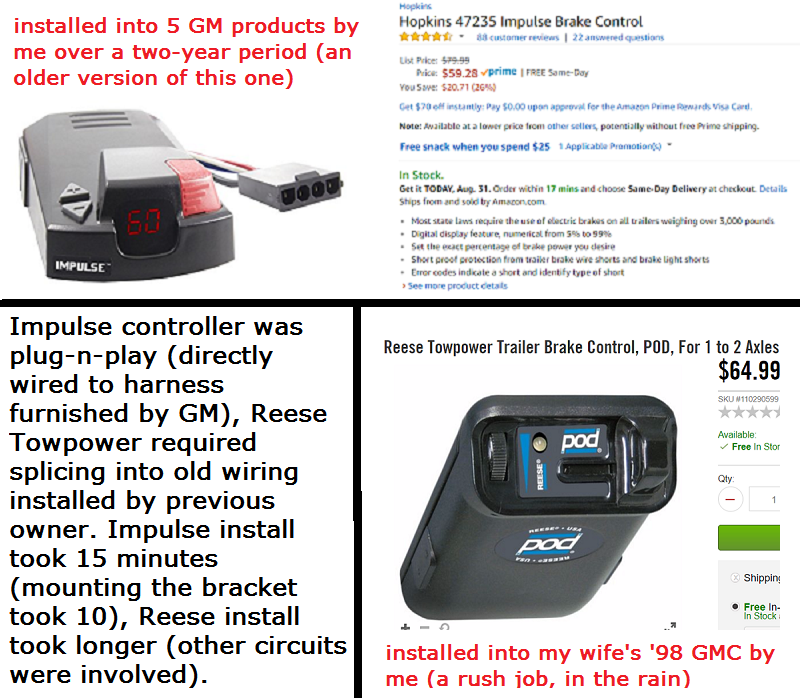

Postby working on it » Thu Aug 31, 2017 12:29 pm
elcam84 wrote:...At some point I am going to replace the factory axle on my flat bed trailer with a torsion with brakes. Unfortunately adding brakes to the trailer is the cheap part the controller for the tow vehicle is the big cost....
  • I've installed at least ten brake controllers in various trucks and SUVs over the last 25+ years, and have found them not as expensive if you do them yourself. I remember a friend paying big bucks at a U-haul, years ago, to have one put in his truck, so when I needed one, I opted to do it myself. It was a cheap time-controlled Reese unit (I don't remember the model or where I bought it) that I wired myself, using connectors and electrical stuff from a Hi-Lo auto parts store. I was never good at wiring under the dash, so this first attempt took me awhile, but it worked. After that, each install became easier.
  • My last install was at twilight, in the rain, as my wife was about to pull her 20-ft Puma travel trailer to Minnesota on a catastrophe insurance job, because her old Tekonsha suddenly stopped working. It wasn't a fuse, so I rushed to Tractor Supply, grabbed a Reese controller, and started to splice it into the wiring of the '98 GMC. I didn't like the way the previous owner had wired it into shared circuits, so I simplified it, so if my wife experienced problems on the road, a mechanic could easily trace the problem. Took about an hour, because it was raining and dark, and I don't fit under dashboards very well.
  • Though I've used mostly Reese-branded controllers over the years, due to widespread availability, I bought a Hopkins Impulse controller (at Northern Tool?) for my '04 2500 HD Chevy. There was a harness for the truck to hook up a brake controller (it was loose, in the glove box, to be installed by the user), that made the installation plug-n-play. The selection of controller location, and drilling and mounting the controller, took much longer than the wiring. Probably 30 minutes. Later, I installed the same controller into friends/family 's vehicles 4 or 5 more times (into Avalanches, Suburbans, and more 2500 HD pickups). They liked my controller, so I installed all of theirs the same way, each install in less than 15 minutes.
  • As for cost, I've never paid more than $60 for any controller, most being under $50. The new plug-n-play wiring harnesses (they were included with the GM vehicles) would've cost under $20 at GM (but even less from various retailers), so these installs were way less expensive than the U-Haul install of olden days.
    my latest brake controller installs.png (337.48 KiB) Viewed 1277 times
    controller installation is cheaper and easier than in the past

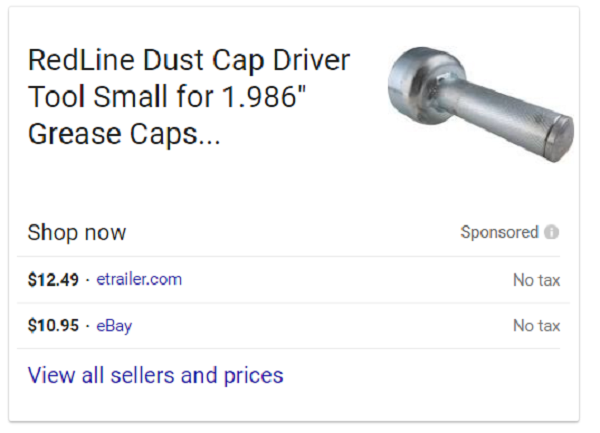

ae6black wrote:. does anybody know if they make a tool that you can use to pound the dust caps in with?

Postby elcam84 » Thu Aug 31, 2017 9:20 pm
ae6black wrote:I just went to the local auto zone and bought a controler off the shelf. Had to replace my original one because I wasn't paying attention and wired it up wrong and blew it up. But considering I'd had the old one on three different tow vehicles, I don't think it was that great of loss. If I hadn't lost the instruction sheet that came with the first one, I'd probably still be running that one. Being in a hurry will get you every time. With this axle install I was quite disappointed that it came with bearings already packed. I like to pack my own. but because they didn't give me extra seals with the hubs I bought I went ahead and used as it was. This axle came with a grease fitting in the ends of the spindles. weird looking set up. the fitting is mounted off center of the spindle and grease apparently comes out near the inner bearing. So I pumped several times with my grease gun and hoped for the best after I put it together. I'll repack it next season just on general principles. does anybody know if they make a tool that you can use to pound the dust caps in with?
Art
That's a dexter ez lube axle. Just grease it and go on. It works very well and will continually flush out the old grease when you pump in new stuff.
There is a dust cap tool. Goofy pliers with a hammer head on it. Never bought one as an ASE tech. Screwdriver to pop them off and smack them on with a hammer around the edges. If you are worried about denting find a piece of pipe that will fit and use that as a driver.

Postby working on it » Thu Aug 31, 2017 9:52 pm
  • Yeah, me too. I sometimes get mad enough to use a sledgehammer on one...but usually I use a dead-blow hammer, or fit a large socket over it, or a piece of 2x4. A friend, with tools for every purpose, has a dust-cap-specific tool for his dust-caps (and a driver for every bearing size, as well).
    dust cap driver tool.PNG (89.09 KiB) Viewed 1141 times
    there's a tool for every job

Postby ae6black » Tue Sep 05, 2017 5:27 pm
I guess I deserved the hammer picture. Never heard of the dust cap driver. Got one ordered. Thanks for the good advice!
