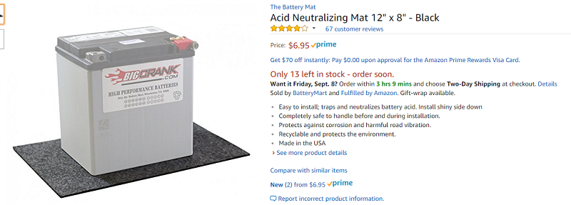

  • I've found that venting is really only needed when charging, at higher charging rates; trickle charging doesn't produce much hydrogen, as I have tested that effect many times, personally. I formerly used my HHR Panel as a icy-weather sleepover base (when I couldn't commute 120 miles on ice, before I retired), and would sleep with my head directly over where the battery was, under the rear floor. The vent tube was broken after about a year, and I didn't replace it, so I slept in that un-vented vehicle at least 20 times, and never once detected any gas. Even after I would drive it for hours (with the alternator charging), and open the rear hatch, I never smelled any hydrogen (cars aren't built to be airtight, unlike my TTT squareback, which is, almost).
  • I also had three VW bugs, back in the day, and only once smelled hydrogen, when the generator was overcharging, due to a faulty voltage regulator (the batteries of old VW bugs was under the rear seat). Unless your battery box sits near a spark source, or open flame, I wouldn't worry too much about it; just have the vented box in a safe location. As for possible battery acid spills and/or corrosion, I've used acid absorbing mats under some of my batteries, when I expected rough conditions to possibly spill some acid, or when I intentionally charged my batteries at an extremely high rate (between rounds, when drag-racing my Chevelle).
    acid absorbing mat.PNG (160.11 KiB) Viewed 1423 times
    if you use a metal battery box or tray, this is needed
