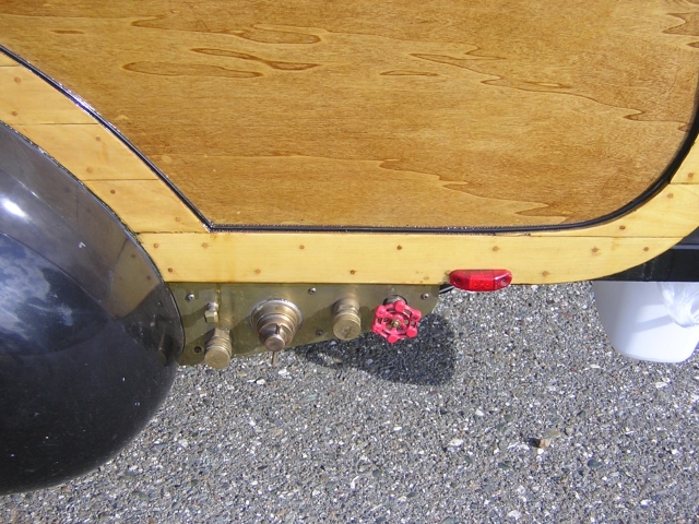

Below is a picture of my favorite under-carriage/side controls:
From looking at your pictures, it looks like you have a teardrop, possibly a Little Guy. I would think that you could do something similar to the picture shown above, maybe bolting an additional, thinner piece of 'C' channel, or something of that nature, to the carriage. Get your exterior connections first and then see how big your bolted piece would have to be. Then drill holes for the connections and for attachments and fit them in. You might be able to use the existing chassis channel, without the additional piece; but, you'll have to decide that. You don't want to compromise/weaken the existing chassis by drilling too many holes too close together. That's why I suggest adding a piece, to be on the safe side. Once you have the exterior connections, you can use either plumbing fittings up to your tank or hoses; or possibly a combination of both. If you use hoses, you may want to upgrade those from what is sent with the tank. There is a hose that you can buy at the local box stores that is reinforced and stronger. You'll see what I mean when you look at the water tank hose material. Metal plumbers tape may be okay to use to secure the tank under the deck. Place the tank according to your available space. Remember to allow for the spring action of the undercarriage when your trailer goes through potholes, etc.

I like the early style application you have there! My old plumber friend Stanley would have approved! e

...Not mine. Belongs to a friend. :)

I LOVE how classic that looks
