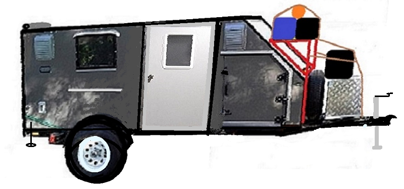

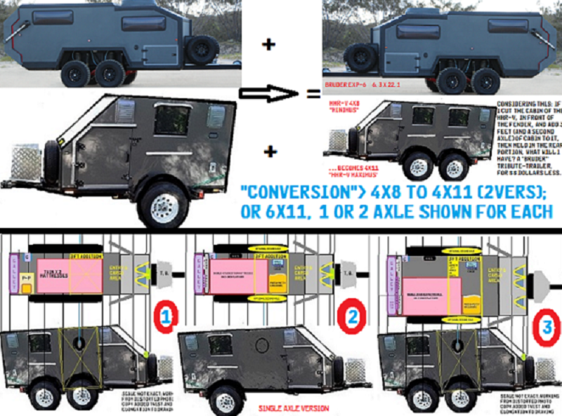

  • I love my little (but very heavy, at 2020 lbs loaded) 4'x8' squareback trailer. I designed and built it starting over 6 years ago, long before my knees and back became really bad, before frequent restroom needs at night became a real issue, and before loading/unloading the gear needed on a camping trip became another issue, now that I'm a bit more worn-out. I've actually spent more time addressing those issues than I've spent camping, so I might just as well modify it a little more, while stuck at home for awhile (if I can't camp, then plan and build for when I can camp!).
  • I've prepared nighttime facilities for myself, in the form of a porta-potty tent alongside/partially under my canopy, with a Luggable Loo inside. For liquid-only relief, I have a urinal that routes thru the floor into a 5-gallon, sealed container, that can be easily toted home for emptying. The relief for my knees and back was harder to come by, since I designed small doors at the front of my cabin, requiring me to "dive" forward under an overhead shelf...easy to enter and exit previously, now only with some help I've added. I put an overhead crossbar, with handles and a hanging "noose" in the center, so I can lift myself up from the bed, and use the handles to swing forward thru the door(s) when exiting. And, since dressing inside has become a chore, I have a second side-tent, that attaches directly to my canopy covering the second door, so when I need to change/clean-up, I can use it if I need the extra room. Actually, I probably won't use both side-tents at any one camp, unless I'll be there for an extended stay...they get to be a hassle to pack up (as are my two canopies, since I camp solo).
  • Speaking of a hassle packing-up, I've added more storage in the form of a front rack over my sloping front roofline/tonguebox area, to carry both canopies and a chair-in-a-bag, weighing about 100 lbs total. That way, they're always ready to go, without trouble, between outings. I can also strap my portable pantry to the rack, on top of the tonguebox, if perchance my truck bed is full, but probably won't.
  • But since this thread is about a do-over, not livability modifications to an existing trailer, I've already recently posted my plans for a longer/wider version of my 4' x 8' trailer, made by cutting it apart, adding structural members to frame and body both, or transplanting the enlarged body to a pre-constructed, bigger, trailer frame (6' x 12' most likely). My plans are shown here: http://www.tnttt.com/viewtopic.php?f=53&t=69012&p=1216661#p1211474. Here's one drawing, with 3 versions, from that post:
    Bruder-inspired variations of the HHR-v.png (696.45 KiB) Viewed 1028 times
    I can dream, can't I ?
  • Right now, all my attention has been focused on demolishing our failing double-wide manufactured home (44 years is too old, when built to lousy 1970's standards), reconstructing our pad/patio/retaining wall (we're on a sandhill that tends to flow downhill), and moving in a new, better-built double-wide to replace it. We're also re-doing our septic system for better flow, and all new water lines underground (our old lines ran thru a neighbor's property, and were often damaged by his projects there). And, we're finally upgrading our electric service from 100 amp to 200 amp. Packing up the saved contents from the old house took up two storage containers, three sheds, and my 1/2 empty 3-car garage (all stand-alone structures), and we left a few items in the house to be disposed of along with it. But, my wife had me save our 6-month-old back door, which she said she might use on one more shed to be built. But, I envisioned using it on yet another modification to my existing trailer, as a larger side door for an easier entry/exit. I made a quick drawing of it added, after being cut-down to 46.5" tall (my trailer's inside height). Once again, about three feet will be added to the center portion, after the trailer is bisected, but using only a single axle, I would move mattress forward and porta-potty and heavy items rearward, to offset the gain of mass in the center.
    HHRv MAXIMUS, vers.4 with reclaimed door.png (365.89 KiB) Viewed 1028 times
    proportions are inexact; but I'm a dreamer, not a designer
