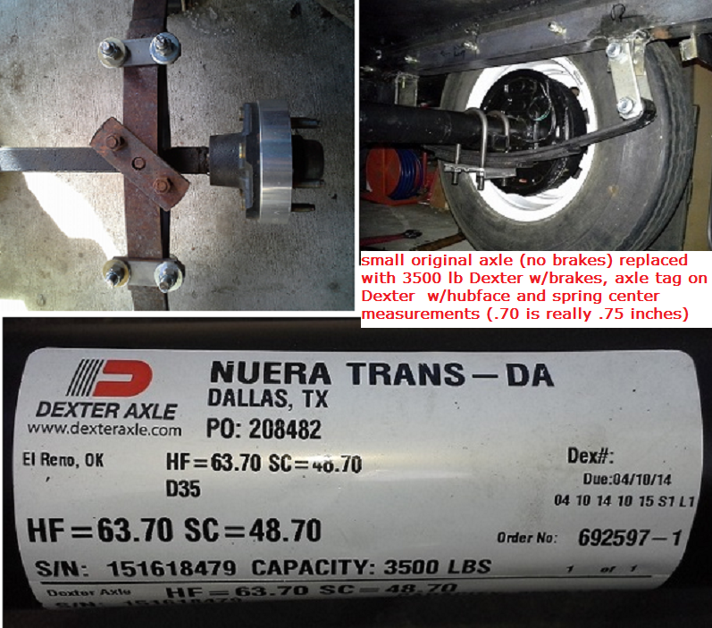

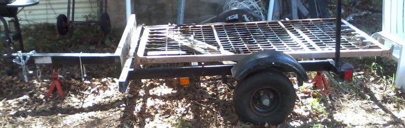

  • Brakes may come in handy if you tow a heavy trailer with a lightweight vehicle, or in mountainous terrain. Or, just for added stopping power, for safety's sake. My original trailer axle was of unknown weight capacity, and was never intended to have brakes, so there were no brake flanges. When I needed to replace the axle with a higher weight capacity set-up, with brakes already installed, it was made to order for my trailer frame rail measurements. So, you can start out your build with a HF or NT trailer, and change your axle out later, to one with bigger bearings, higher weight capacity, and with brakes, if those improvements are needed.
    original trailer, 50x60 inches, small axle, no brakes.png (413.34 KiB) Viewed 627 times
    very small trailer with 8" wheels at start of build
    axle changed out.png (775.79 KiB) Viewed 627 times
    overgrown (1625 lbs at the time) trailer needed a total upgrade of the suspension
