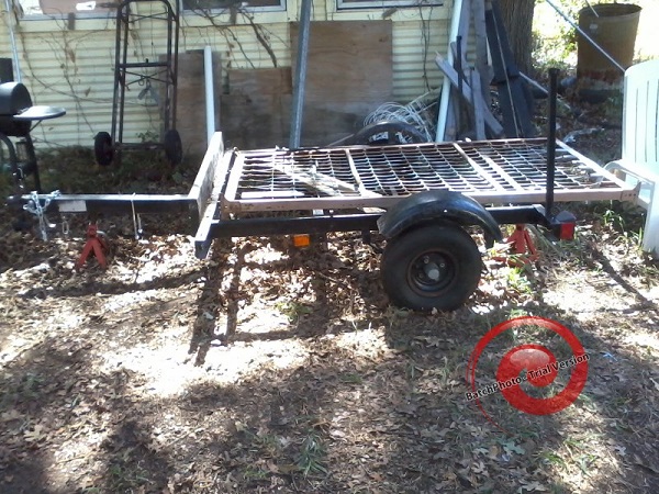

  • I bought my junk trailer at a swap meet for $50, after I had already bought a junk mini-bike from the same guy for another $50. I wanted the bike, but only took the trailer as an impulse buy. I rebuilt the bike, and later sold it for a good profit (for barely used racing equipment and parts...you can never have too much), and built another that I still have, but am too old to use anymore. But, the derelict trailer was never used, for about twenty years, after I made a few repairs to it, and tried to give it to a relative to haul his ATV, but he used another. So it sat, in a swampy part of my property, rusting away, for two decades.
  • I decided to resurrect it, transform it, and use it myself, after reading about small trailers on Expedition Portal, and later here, at TnTTT. I had known about teardrops since the 50's, and liked the layout and campability, but wanted to do it a little differently, and tailored to my (lack of) building skills, and the intended use of it later on (semi-offroad, off-grid camping). I ha little or no budget, and pieced it together a little at a time; I often used re-purposed items (gate hardware and pipe clamps), salvaged parts (ST tires, with many patches, from my friend's junk pile), and borrowed parts (the spare from my wife's business travel trailer, and jack from my car-hauler), and traded my labor on other projects for my friend's welding skills, as I added steel extensions and a whole new tongue to the tiny, crappy, original frame.
  • I knew that the original axle and springs (on a trailer that initially had 8" wheels) would be incapable of off-road travel, or even carrying heavy loads for long, but I used it as-is for over a year, until I had a spring hanger tear free, and added a heavy-duty axle suspension set-up, that I knew I would need for the end usage goal of rugged travel. I had long before upgraded bearings, hubs, and added 14" wheels, to make it a little safer, but the original was only kept until I could justify the expense to my wife (after promising I could build it for $500, she had gotten wise to over $2k of parts passing thru my garage door...she never saw much of it!). I spent what I needed to, and when I needed to spend it; that's reason enough for me.
  • After I built it (but never finished it, because a good project keeps on getting modified!), I often thought of how much better a custom frame, with the ideal suspension and axle would've been to have, making the build quicker, easier, and resulting in a safer end product, but then I wouldn't have learned some skills I developed along the way, or fully utilized some I already had, if the trailer base I started with had been suitable from the beginning. In my case, the building experience, and the problem solving I did to make it all work, actually were as enjoyable to me as all the camping I've done since. The best part in the journey, is the journey itself, rather than the destination.
  • My user name (a variant of which, I've used on many forums for 20+ years) reflects what I used to be, a guy always "working on it", on one project or another, for most of my adult years. Not so much now, but that's where I got my most pleasure from. If constantly working on, or fiddling with, a trailer and its' thousands of parts is not your thing, then a custom or ready-made frame is the best way to go. I'm sorta glad I chose a road less traveled, but enjoyable nonetheless.
    junk trailer, with twin bed frame for size comparison.jpg (169.77 KiB) Viewed 1162 times
    very few trailers have started with more dismal features
