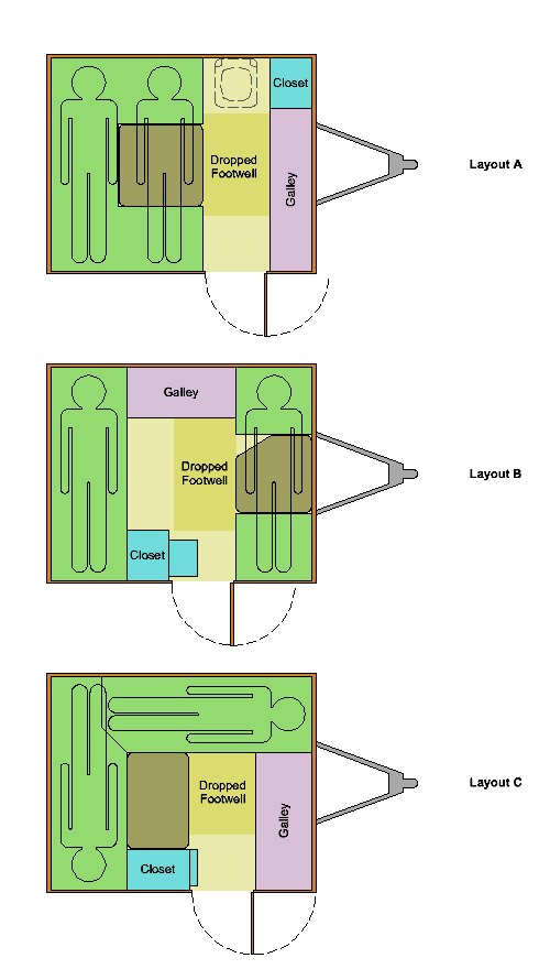

Click on the Design Resources at the top of the page. Go to Rescued Library. There are at least 3 designs that might match up with what you are looking for. Here is a diagram of the first one I came across.

greygoos wrote:Click on the Design Resources at the top of the page. Go to Rescued Library. There are at least 3 designs that might match up with what you are looking for. Here is a diagram of the first one I came across.
Already saw those. What I don't want is a dropped foot well. Just want to know, is there any reason, not to build one, that you can completely stand in? I know high winds can be a factor, for stability. However, I believe 6 1/2 x 8, should be a pretty stable platform, even at the 6 1/2 foot height.
