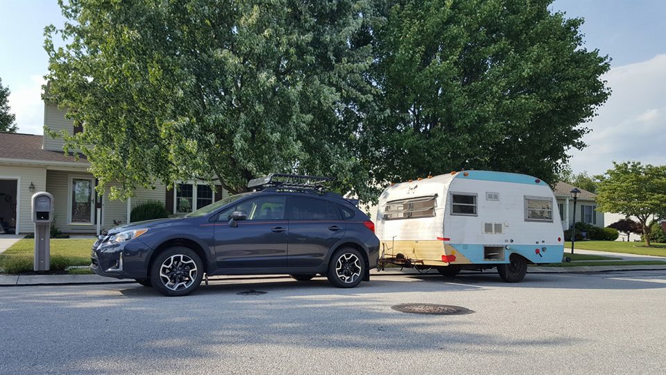

Having just jumped into the Scotty world this year, the biggest thing to look out for is roof leaks. They're notorious for them. And if there is a roof leak, it most likely rotted away portions of the walls, or at least deteriorated them. I'm in the process of rebuilding a 1976 from the ground up. My hopes were to tow it with my Subaru Crosstrek, rated at 1500lbs towing if the trailer has brakes. Here we are getting it home in June...
Yes, the advertised weight of an original (not rebuilt) 13' Gacho (10' + tongue) was 975lbs. That's dry weight. Without water, without propane & tanks, without batteries, no air conditioner. Nothing. Empty. Start adding in the amenities and It will add up quick. Then throw in some camping gear and living supplies for an extended trip and you're way above 1000lbs. Depending on how it was rebuilt, it could be quite a bit heavier if the materials used were thicker and heavier than original.
I will not be keeping the onboard water tank, but will be adding two batteries right where the water tank was (under the gaucho bed). I'm hoping this lightens the tongue enough. Time will tell. The tongue weight is a concern, as my Crosstrek is limited to 150lbs. If the finished Scotty does end up coming in too heavy, we'll be putting a hitch on my girlfriends Renegade (2,000lb towing, 200lb tongue weight).
With even the smallest Scotty, I think its going to be a bit large for a Honda Fit, unless you're just towing in a straight line through the cornfields of Kansas. The Crosstrek has a pretty small engine, (2.0L engine rated at ~150hp, and about the same torque) but in the name of fuel economy, it looks like the Fit is quite a bit smaller with a 1.4L engine, rated at 130hp/114ftlb torque. The Fit is lighter than the Crosstrek, so I'd have concerns about the tail wagging the dog. I won't tell you not to do it, but I don't think its a good idea. If hypermiling and camping are your two hobbies, one is going to constantly fight the other.

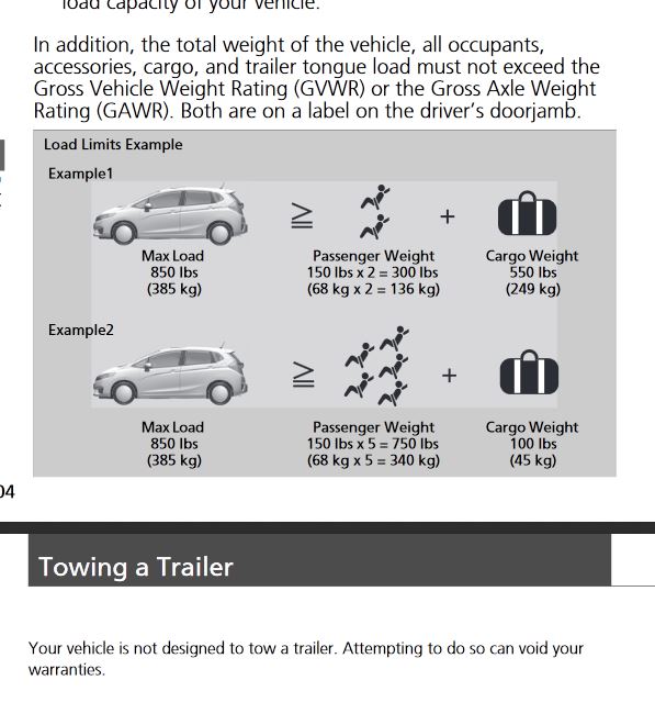

I'm curious where you're getting the 1500lb tow rating for the Fit. The owners manual for many of the years even states that the maximum load capacity is 850lbs (including driver, passenger, and gear), and that the vehicle is not designed for towing.
I just don't see safely towing a 1000# Scotty with a FIT. its not just the going. Its the stopping. And the weight and balance ratios that change the handling characteristics and vehicle dynamics. I would say its your car so you can do as you please, but as soon as you are on public roads, your actions affect others.
If you want a bigger camper, get a bigger a vehicle.
