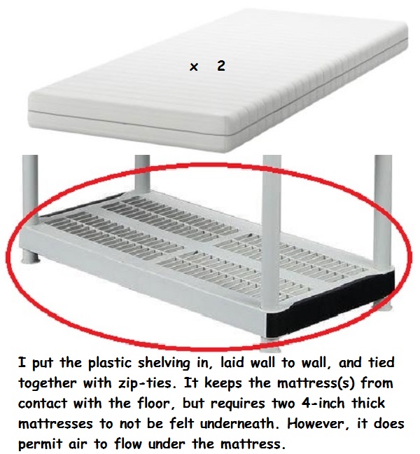

  • I never perceived a dampness problem under my mattress, probably since I use rubber/carpeted commercial floormats, cut to size, between the floor an the mattress. But, I did have a water under the mattress problem, which I tried to forever avoid again, if possible.
  • from another thread
    working on it wrote: but I am going to use plastic shelving material under my mattresses, 2 Ikea Sultan Florvag twin foam pieces, as a spacer/waterproofer airgap (I had a tremendous door seal leak flood my cabin-not going to get my mattress(s) wet-goldarn it). Since the mattresses already have covers on them, and will also have a 5 mil thick waterproof bag over all...
    ...I most likely will not have a wet mattress to sleep on , anymore.
    plastic shelving under mattress for airflow & waterproofing.jpg (114.45 KiB) Viewed 3314 times
  • I tried it out, on a three-day camp-out, but since I had cut-down one of my mattresses to form an angled/inclined bed, the steep angle coupled with the super-slick waterproof mattress cover, combined to cause me to constantly slide downhill. I'd wake up in a ball at the far end of my cabin, with a back-ache. Another great idea, but poorly executed. The bed spacer will stay, but the sliding mattresses will go. I'm switching over to a four-part folding 4" mattress, with a zippered cover (for cleaning between outings, if needed), and using one of two sleeping bags (one summer weight, and the other for colder weather). I won't miss the difficulty changing my bed-linen, anymore, which has been especially difficult, using two mattresses, and having my doors at the very foot of the cabin, with the head area beyond my reach! I think the folding bed will be firmer than the Ikea mattresses, so my bed-spacer will not be felt pressing thru, but if it does, I'll find a way to fix that, too...the mods keep on 'a rollin', as they say....
173193172890148599
working on it
Posts: 2189
Images: 457
Location: DFW Texas
