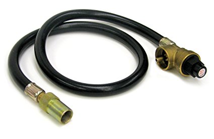

Does anyone know if Coleman (or anyone else) makes an adapter hose for the newer Coleman two burner stoves like the one in this pic?
It will replace the fixed tube type connector that comes with the stove for use with the one pound propane bottles.
I need to be able to move the bottle when using the stove inside my camper.
The one in the pic is made by Stansport and is listed on Amazon but the Q&A's say it does not fit the Coleman stoves.

Your picture looks like the "Stansport 30-Inch Hose with Regular Appliance to 1-Pound Cylinder" on Amazon.

Yes, and his original post says it doesn't fit Coleman stoves.

Most of the Q&A's say that it doesn't fit most other stoves and some even say it won't fit all Stansport stoves. Not sure if there is a standard fitting that all stoves use or if they each have their own proprietary connections.

I've looked all over the internet and they all say the same thing "not available". Coleman doesn't list it on their stove parts web page. There are discussions on several other forums that say the hose type regulator has been discontinued. I'm thinking I can buy the solid tube type that comes with the stove (Walmart and Amazon both list them for $15) and simply cut the tube and install my own hose. Normally I can use the stove outside on a table. I need the hose type for the infrequent times that I might have to use the stove inside my camper since the cabinet that I will use for the stove isn't big enough to hold the stove and the propane tank on the end of the tube type regulator.

Can you just cut the existing rigid tube between the stove fitting and the regulator and hose clamp on some low-pressure propane hose? Then the regulator and adapter to 5 gallon BBQ tank can be at the tank and the stove can be in the galley. Just an idea

Get hose with 20x1 inch (disposable bottle connection) on each end and just add it to existing hose...
https://propanewarehouse.com/shop/campi ... alefemale/
Or if you want to go from 20x1 inch (disposable connection) to POL ( "x" gallon tank) ...
https://propanewarehouse.com/shop/acces ... hose-wpol/
Got picture of hose/fitting you are trying to replace...

No, the stove end is also a female fitting and about 1/2" diameter.
