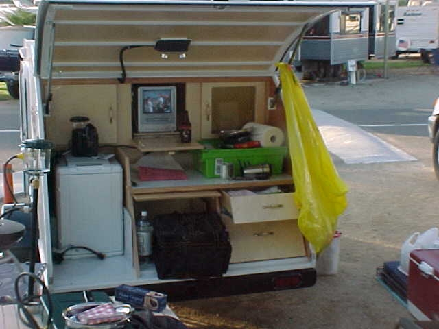

Postby dmb90260 » Tue Feb 27, 2018 9:49 am
My tear camp with the "fridge" on the left of the galley. I cannot recall the brand. It was not a real refrigerator but an electric cooler that kept the interior 20 deg below the ambient temperature. Not must use when the temps are very high or very low. It became mostly a storage area. I had one or two Colemans in my truck bed which were better. I would have been better off with more real storage than this fridge.
