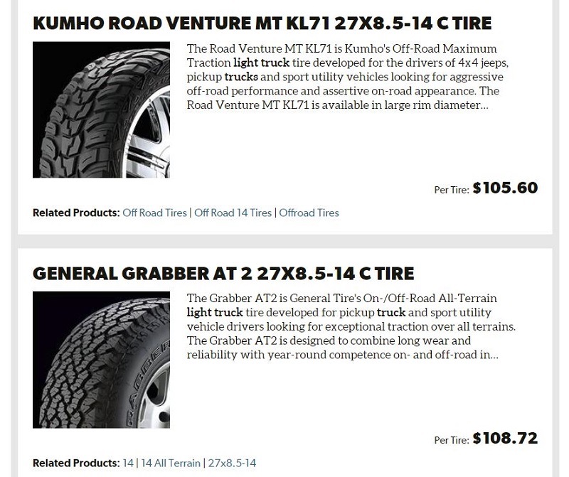

  • I used (very used, 12+ years-old, with age-cracking, and multiple plugs/patches on each) Carlisle bias-ply ST tires in ST205-75C 14, until last year, when I switched to LT tires on my TTT. My trailer had grown so heavy, that I just knew that it was past time for new tires, so I tried to find good non-Chinese tires(I've had bad luck with some) as replacements. I also wanted tires with good tread design and firm sidewalls, so LT tires were my choice (General Grabber 27-8.50-14 AT2, bought via Amazon).
  • Granted, you are running 13" wheels, instead of 14", but you might consider getting larger wheels to fit the larger/stronger (more capable LT) tires, just for safety's sake. 14" or larger, is the way to go, because there are absolutely zero LT tires out there in 13" size. I still use one of my Carlisle bias-ply tires as a spare, JIC, but intend to get another AT2, soon, but I travel over mostly good roads, and in daylight, so it's not a priority, yet. If I were to undertake a lengthy trip, over unknown roads in varying states of repair, I'd be sure to carry a really fresh spare (identical replacements might be hard to find). I could only find two brands of 14" LT tires, at that time, but have since found another brand, Kenda, a Chinese tire.
  • Investing in new tires and wheels would be achievable for under $500 in the US, but for an unknown cost in Canada; but that would only be a fraction of the cost of your contemplated trip. I think it would be worth it.

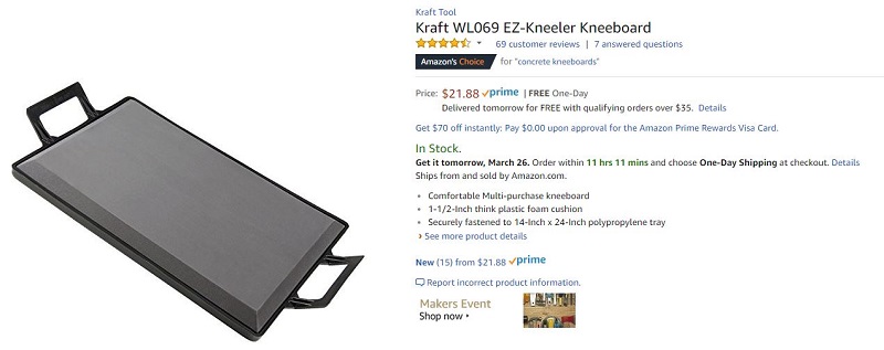

  • If you do experience problems on the trip, in any case, I would bring an extra jack along, and one or two jack-stands, as well. A roadside kit (with reflectors, flares, and cones), would be nice to have, too (I've meant to get one for my TTT, but keep forgetting to, after I lent-out my kit from my race-car hauling days). Another suggestion is to get a kneeboard, for roadside use, and save the tarp for laying on. My old/bad knees appreciate the added comfort, much nicer than kneeling on rocks and pavement. Anyway, good luck on your trip!
14 inch LT.JPG (170.06 KiB) Viewed 2032 times

I would consider larger tires except i already had to install wheel spacers for these and bolted my fenders on. Wider tires would need wider spacers and wider fenders. Hub spacers is the eventual plan, but i doubt ill have time before our first trip. I didnt realize these were bias ply until just now. I know tires arent a big part of the whole cost of my trip but the trailer is already at least 3x over budget and it seems stupid to replace the brand new tires that came with the new trailer, but thats what im still leaning towards. The radials in the same size have a load rating of 150% of the max weight i plan to have that trailer which i think is a reasonable margin.
I see people all over the internet saying to use truck tires instead of radial trailer tires but i either havent seen anyone say why or i am missing it somehow when i do see it...
Thanks for the tips!

LT vs ST tires. A good ST tire can carry a heavier load and result in better trailer control with the stiffer sidewalls. The ST tires will also stand up to a lot of abuse like rubbing a curb.
A couple links worth looking at
https://www.tirerack.com/tires/tiretech/techpage.jsp?techid=219
https://rvingwithmarkpolk.com/2012/11/08/trailer-towing-st-tires-vs-lt-tires/
Since you are well under the load rating for trailer tires you should have no problems. I have a boat trailer with ST 215-75R14 tires (1870 lbs at 50psi) and is very close to the max load limit. I tried Nanking tires for a while, but weird wear and bulging. I had a Carlisle tire as a spare. Never used it but eventually replaced it as it developed a scary looking bulge without ever being used. I have Maxxis 8008 tires on there for years now and they are great. I am using Gladiator on the teardrop and am really happy with those too. Weird thing about trailer tires is how little stock the tire shops carry. Once summer hits a lot of shops just run out until they get new stock next winter. Call around to a few shops in your area and see what they tires they have 3 of in stock. Maybe that is a reason some people like LT tires, easier to find.
Also - I get my trailer tires balanced. Some people don't but it only makes sense to me.
