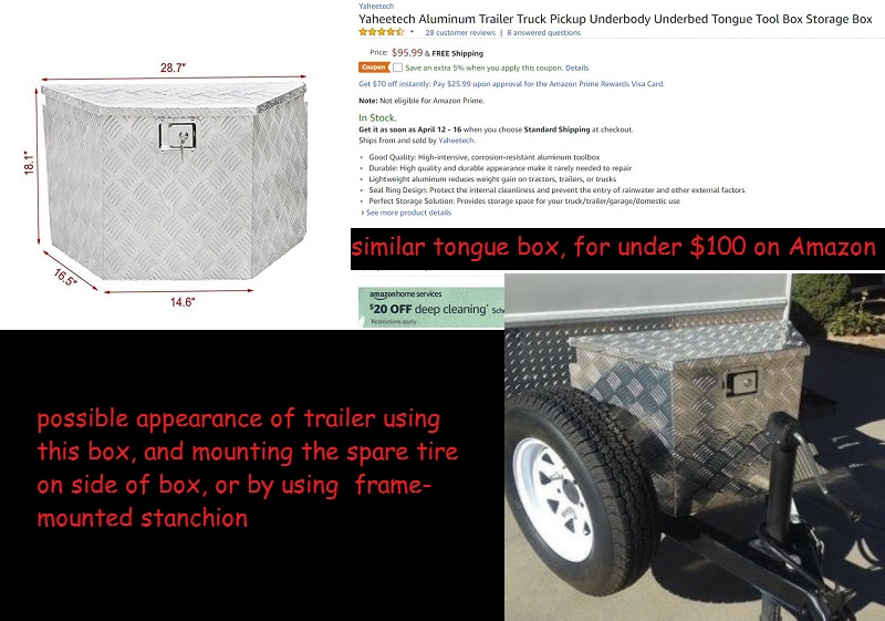

  • Well, my set-up is pretty unique; it's my solution to fix my trailer balance problem, without having to re-mount my spare tire, too. I had originally thought to carry all my extra gear (spare parts, electric extension cords and adapters, peripheral equipment, etc.) in the rear of the trailer along with battery, generator, Coleman gear, and Aquatainer jug, and place my spare tire in front, for easy access. I had looked for a small-ish tongue box for the extra gear (hoping to free-up room in the rear to try to use it as a "galley", instead of storage only), but couldn't find one for under $200 (at that time, when my build was a no/low budget affair). But, I soon discovered that I needed to move some weight forward to the tongue, as an interim fix for the rear-bias weight distribution I had.
  • I "engineered" it for carrying heavy coolers inside, as an offset for that imbalance, but it wasn't enough, so the battery, at least, could go to the tongue. I first tried using a Husky toolbox from Home Depot (it was black diamond plate, and looked nice) that I bought, and put the Optima Yellowtop AGM battery inside, along with some tools and spare hardware. But, as heavy as it was, it left me 40 or 60 lbs short of balance (per calculation, and per scaling). Either way, it was too little. Then, a fellow forum member (Prem) found and suggested a small/cheap aluminum box he spotted on E-bay, that I could use. It was the solution I had needed, but I had no desire to move the spare elsewhere, and it was already an integral piece of my weight puzzle, situated where it already was.
  • I measured the space I had available in front of the spare, and behind the removable jack, and found I had just enough for that new box, with around 5-6" to spare. I purchased the aluminum box, and test-fitted it, and then decided to make a slide-mount for it, so as to use it to block access to the spare, until I needed it. I found a boat-seat slider on E-bay for $10 (I think), and bought two sets (spare parts, you know), and rigged it up. It works great, and has since worked well for me for 5 years so far, loaded with bout 150+ lbs of stuff I no longer had to carry in the galley, anymore. And the spare remained in front, and the jack stayed there too. See this http://www.tnttt.com/viewtopic.php?f=2&t=67730&hilit=slide+tonguebox#p1194100
    first box, replaced with a slide-mounted larger one.jpg (252.27 KiB) Viewed 1979 times
    aluminum box, good for many trailer applications.jpg (174.96 KiB) Viewed 1979 times
    aluminum box, inexpensive purchase from Amazon.JPG (145.27 KiB) Viewed 1979 times

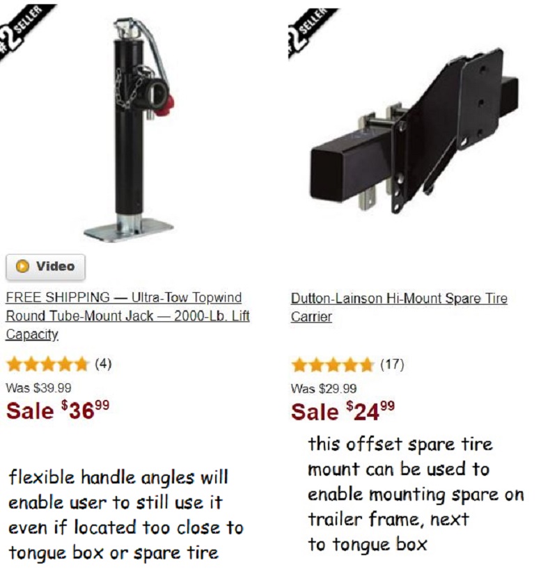

Postby mary and bob » Sun Apr 08, 2018 2:22 pm
Very last picture in previous post shows a side wind jack like I suggested

  • True, but even with the current jack he's using, if there's enough room fore-to-aft, and with the spare tire mounted to the side, then a top-wind jack could be used. On my top-wind jack, the original handle was too long, and I made my own to keep from hitting my knuckles...then I swapped the handle with the shorter-length handle, from my other top-wind jack (located on my car-hauler trailer, less than 15 feet away, which I had never bothered to compare it with). No problem! Even if there would be some interference, the handle still works if lifted slightly while in use, so there's really no need to get another jack to fit, if the dimensions are OK.
  • I had bought an offset spare tire mount, prior to mounting my spare to the front wall, but gave it away when I decided to use the beam itself to support my 14" tire's weight, instead of a side-mount from the longitudinal beam. But, it would work well, on the OP's A-frame trailer, hanging from and supported by the frame, not the box. My trailer's "A" frame pieces were only installed to provide lateral support/stabilization for my tongue box(s), where the main weight load was already supported by the 3" x.1875" thick square tubing.
    topwind jack & offset tire mount, both from Northern Tool.jpg (124.13 KiB) Viewed 1915 times
