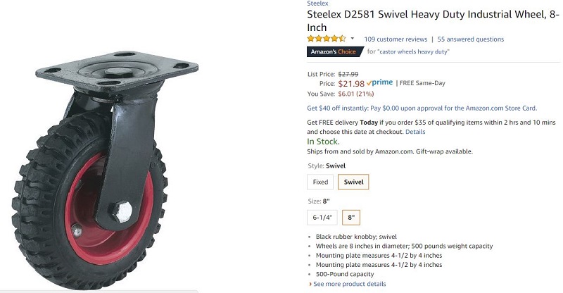

So, I figured that a 500 lb limit, industrial swivel caster would work fine, when mounted to my current jack's sand foot. For $20, and an hour of my time (looking for some locknuts, mostly), I now can move it around OK. The eight inch diameter wheel rolls easily on my mixed surface driveway, and also raises the tongue high enough to easily hook-up to my tall hitch.
Where'd ya get the caster? Have my adapter plate and looking for a good caster that will work.

I found it on Amazon, of course! https://www.amazon.com/Steelex-D2581-Swivel-Industrial-8-Inch/dp/B0000DD1D2/ref=sr_1_7?ie=UTF8&qid=1526223070&sr=8-7&keywords=castor+wheels+heavy+duty
Steelex 8 inch caster.JPG (84.93 KiB) Viewed 3021 times

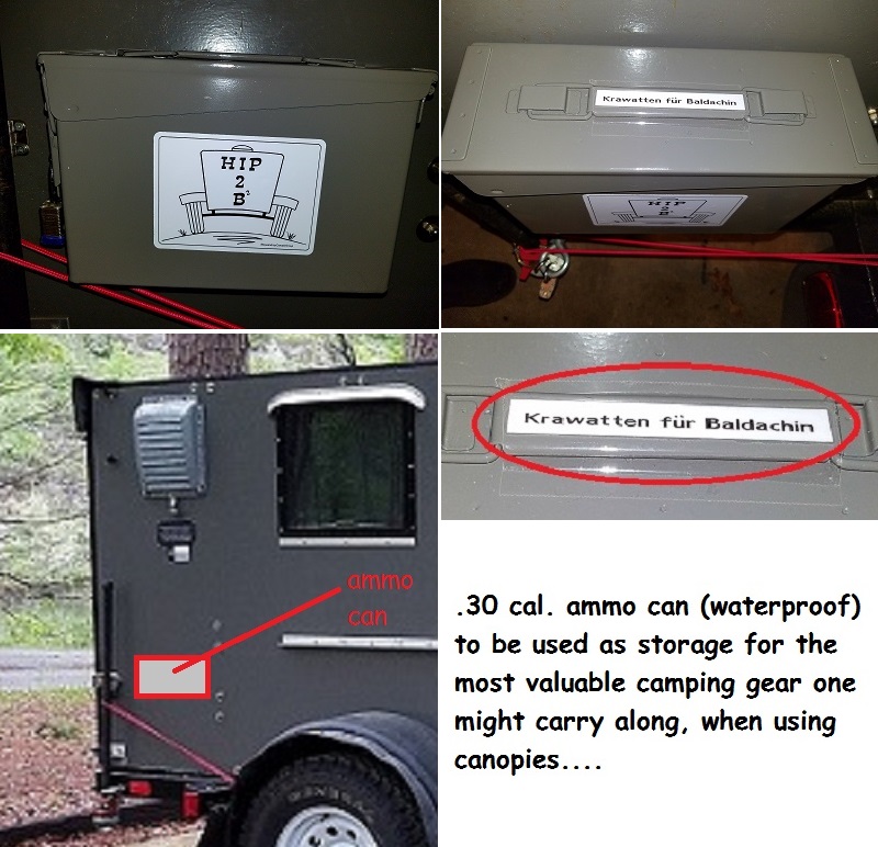

  • Mod #5 is complete, and ready to receive the valuable items to be stored there. I just wanted a different sort of label, just to make it interesting for passers-by.
    ammo can for storing valuable gear.jpg (184.02 KiB) Viewed 2992 times

Love the stickers on your lockbox. :thumbsup:

Sparksalot wrote:Love the stickers on your lockbox. :thumbsup:
  • Thanks. I like quirky metal signs, decals, and stickers that personalize my trailer. I had an old S-10 pickup, with a Delta in-bed toolbox, that I had all sorts of decals on, then I just followed that up with rear window stickers/decals on my bigger trucks (from racing organizations, online forums, my racing team's decal, US flag, manufacturer's decals, etc,), then on my trailer. I try not to put decorations on that might be offensive to others (political stickers, et al,...I once did, and got my rear window smashed in '72). Just quirky, personal stuff. I've even had some made up by signage companies.
    signage collage.jpg (228.92 KiB) Viewed 2903 times

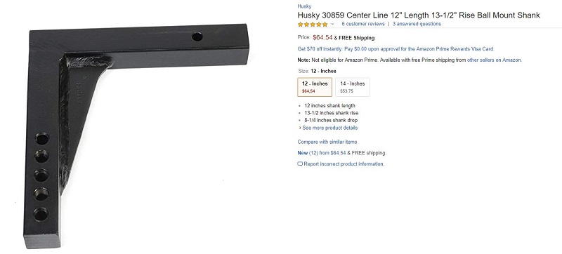

  • Mod #7) Just now realized that my hoped-for SUV I'm trading for, won't be coming anytime soon, due to complications, so I finally bought a drop-shank for my Weight Distribution hitch head. I'd been putting that purchase off, thinking that the SUV would solve the nose-up towing problem. So, the new shank will lower the position of the ball-coupler several inches, so my TTT's nose will no longer point skyward. And it might eliminate the need for using the Weight Distribution spring bar, altogether (though I have relied on using it for towing safety, with no tracking/swaying , at all, for many years), and make hooking-up, backing-up, and unhooking so much easier. Previously, I'd have to use two separate jacks to put the spring bar into position, pre-loaded with ??? lbs of downforce, intended to keep my previously tail-heavy trailer act more balanced on the road, but now, I don't have the tail-heavy low tongue weight problem. A link to another thread detailing the previous problem:http://www.tnttt.com/viewtopic.php?f=35&t=57723.
  • I told the wife I'd discovered a cracked weld in the old shank, and justified the purchase of another, deep-drop shank, to replace it. My old eyes thought they saw a crack, but when I removed it today (a real bear of a job, with the whole assembly rusted after 13+ years untouched), it was just a deep scratch in the paint, with rust/dirt packed into it. Anyway, I bought a new shank. It's solid steel, weighs 31 lbs as-is; it should last a long time.
    deep-drop wd shank.JPG (48.42 KiB) Viewed 2716 times

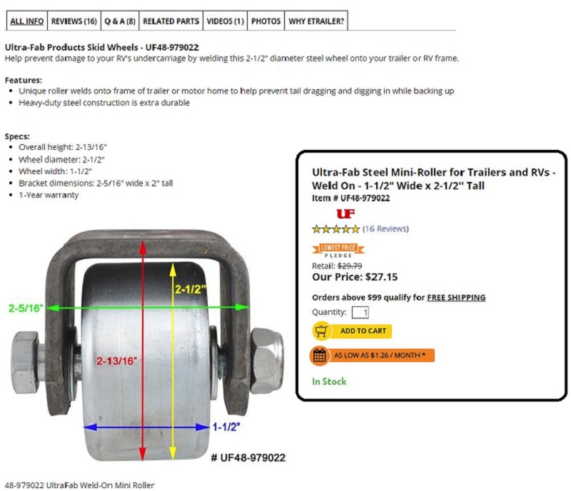

  • If my new deep-drop shank digs into pavement (I'm not concerned about dirt roads...my 2500HD Chevy will just make furrows in dirt with it), or over speed-bumps (my biggest concern, as it seems they are everywhere, now), then I might get a steel roller to weld onto the shank end. I've seen them used with success, keeping low rear-ends on race-car trailers from digging in. My car hauler did occasionally, but I never bothered with adding them.
    mini-roller for shank..JPG (127.72 KiB) Viewed 2599 times
  • Though a roller might make ground contact more often, it should make it less jarring, and/or damaging, when it occurs. It may be my first welding project with my 220vac stick welder (bought in 2014, but never used, due to insufficient garage wiring, now almost ready), if/when I ever finish the wiring (garage still too packed, with my wife's junk from our new home project, to be able to complete). Or take it to a welding shop, nearby.

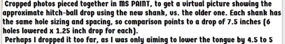

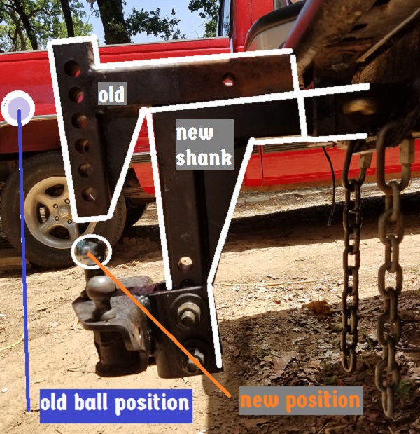

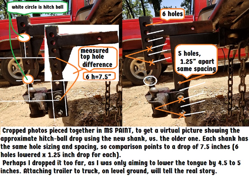

  • As is my usual cart-before-the horse methodology of changing things related to my trailer, I hurriedly installed the new shank, with the WD head set to its' lowest position (as I had it set on the old shank). I bought this shank for two reasons, it was the best/deepest drop shank for the money, and it would give me a wide range of possible adjustments. I was anxious to install it, after 4 years of putting off the purchase.
  • I failed to actually test fit it to the trailer, before torquing the head in place, because of the aforementioned lack of level ground to use, and the fact that my trailer is once again trapped in the garage bay, behind junk, while I move my wife's antiques/collectibles about, inside the garage. It's just too hot to spend several hours out there. However, I actually found a nearly level spot (using a 4-ft level, to be precise, not trusting my vision), where my driveway makes a 90 degree turn, so it will be adjusted/tested if it cools down.
  • In the meantime, while waiting for my wife to return from up north today, probably with more junk onboard her car (with her being out of town, I was waiting, too, for her help in moving her junk around), I referred to old data I had about the amount of drop I had been seeking, before I put the matter on a back-burner for several years. I had thought to drop the ball about 4.5-5", at a time prior to getting my weight balance right, so perhaps that figure would be right now that I was actually doing something about it. I don't know why I overlooked that drop figure, and installed the hitch head in the lowest position ???
  • So, going back out to measure the new drop, but not having measured the old ball position first, I was unsure of the actual amount of increased drop there was (and I certainly wasn't going to reassemble the old set-up, since I have buried it in my toolbox, already).
  • I resorted to using MS Paint, on my PC, to make a crude, pre-industrial, bizarro-world type of photoshop imitation, to get a mind's eye/virtual construction of the ball-drop between the two shanks, to verify that I had really dropped it too far. Plus, I just like fooling around with the program (many, many samples in my posts). It shows that I should've put the top head-positioning bolt into a hole midway between the old and new shank' bolt hole heights. It's 105 degrees outside right now, the wife's home, too, so I can perhaps persuade her to get her stuff out of my way, to do the install correctly tomorrow, in the forecasted cooler weather (under 100 degrees !!).
    shank vs shank, in pictures.jpg (277.16 KiB) Viewed 2576 times

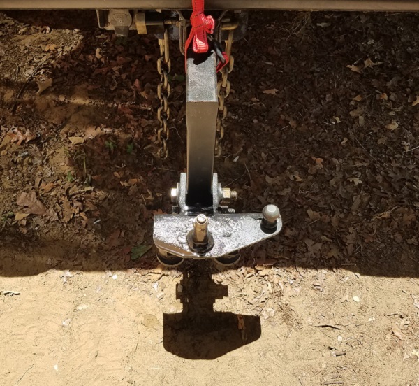

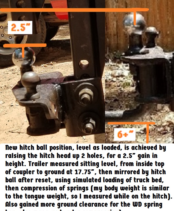

  • Update, next day:The wife & I were too busy this a.m. with tending her neglected, new, flower plantings; I only watered them, but didn't weed the beds (we have an aggressive ground cover of some sort, I dunno what kind) while she was out of town for 12 days. By the time I got around to the truck/shank/trailer deal, she was already cleaned up, and I didn't ask her to move stuff around in the garage bay, to be able to pull out the TTT. So, I just cleared enough space to level and measure the trailer (and yes, my newly modified jack will be too tall, as I feared, after the trailer is set to tow level, but that's a simple fix), and then put my truck on the nearly level ground to compare measurements.
  • The inside top of the coupler (where the ball resides) is 17.75" off the ground, and the corresponding spot on the top of the ball (after I moved the hitch-head upwards two holes on the shank-as high as I could) is 19" (but compresses to 17.5-17.75", measured when simulated loading is done-with me and/or my wife standing on hitch and bumper). It is the max adjustment I could make, but it is probably why I footnoted this particular shank in my notes from 4 years ago, when I made detailed computations. I've since lost most of my collected data, but I did see which shank I had thought would work. It did. I can even fit my Weight Distributing hitch spring bar in, with 6+" of ground clearance, if I choose to continue using it, but probably not.
    quoted caption.JPG (49.52 KiB) Viewed 2534 times
    my guesstimate was correct!
    ball height now set for level towing.jpg (212.93 KiB) Viewed 2534 times
    photoshopped comparisons, again

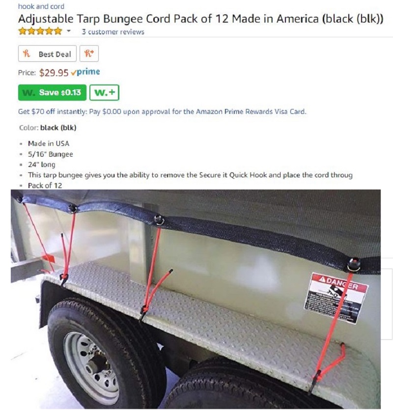

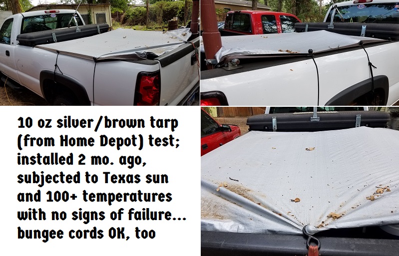

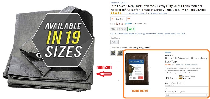

  • Mod #8) not to the trailer, but to my tow vehicle, covering the semi-loaded bed in-between trips and/or for protection from busy fingers at the local stores. I don't travel much lately, whether locally or on camping trips, and I use specific vehicles for different uses; I only use my HD pickup for heavy loads from Home Depot or Lowe's, mostly, and camping, and use our older GMC extended-cab for larger loads (I have a big toolbox, a storage box, jacks, stepladder, & shovel always in my HD truck bed, so there's not a lot of space), and other trips in my HHR Panel. All are kept under trickle-maintenance charging, until I need them, often for two months at a time between trips. Since I don't like loading/unloading my camping gear, I try to simplify the process, by any means possible. So, I decided to cover my camping gear inside my truck bed, and cover it from constant exposure to the harsh Texas sun, leaves or sap falling year-round (I have 30 oak trees), and bird/squirrel droppings. Rain isn't a big deal, because it drains off, or evaporates without harm, to my gear, now that they're covered by a tarp.
  • I left several items in the truck bed, angled for drain-off, and covered all with a 10 oz. silver tarp, held in place with new, strong ball bungees, that have an adjustable-tension hook feature. I've let everything sit in the sun for two months now, with no damage to the tarp, bungees, or gear. I haven't driven at 75+ with it installed, but at 50+55 mph, there's really no flutter. I think its a viable (if redneck) solution to my bed coverage dilemma (I have a cross-body toolbox & a pickup-crane mast in the bed, eliminating any type of manufactured covering). I bought the bungees with balls (ha,ha) from Amazon, and the tarp from Home Depot; I didn't expect the cheap $8 tarp to last (though it has), so I ordered a twice-as-thick 20 oz. tarp from Amazon, to replace it. I may not need to use it for awhile, so it's in the toolbox now.
    tarp & bungee testing.jpg (194.86 KiB) Viewed 2378 times
    new tarp VS old tarp.jpg (110.34 KiB) Viewed 2378 times
    bungee with ball.JPG (166.16 KiB) Viewed 2378 times
  • My tarp solution may not be pretty, but it is functional; until I can have a dedicated-camping-SUV on hand, then this may be what I use from now forward.

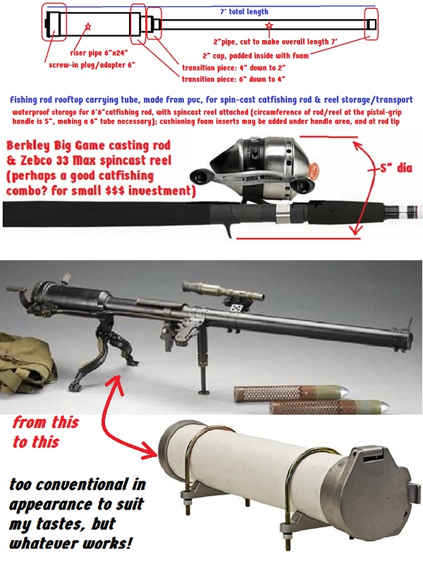

  • While I'm on this thread, I might as well address another mod/addition I'm adding: a rod/reel carry tube, for my TTT. I started a thread on it at http://www.tnttt.com/viewtopic.php?f=32&t=70709, but I've since mocked up the tube before actually buying the parts. A good thing, too, since I found that my planned tube won't accommodate my inflexible-shafted rod (with reel taped & tie-wrapped in place...I've lost two fish, and one reel when I hadn't secured the reel properly). Now I'll get a conventional solution, a conduit carrier kit, so it'll have no neck-downs inside, and can hold my walking stick cane, my hiking staff (both made by me, for the day when I'll need more help...coming soon!), and more items. I was wanting to use up my leftover PVC, but instead will be buying another piece, a 6" x 10-ft, $31 tube from Lowe's, to build it from. That, a $55 kit, a few screws, and two pieces of slotted angle (I love that stuff), and it'll be done (though I truly liked the other design better).
    rod tube re-think.jpg (168 KiB) Viewed 1529 times
