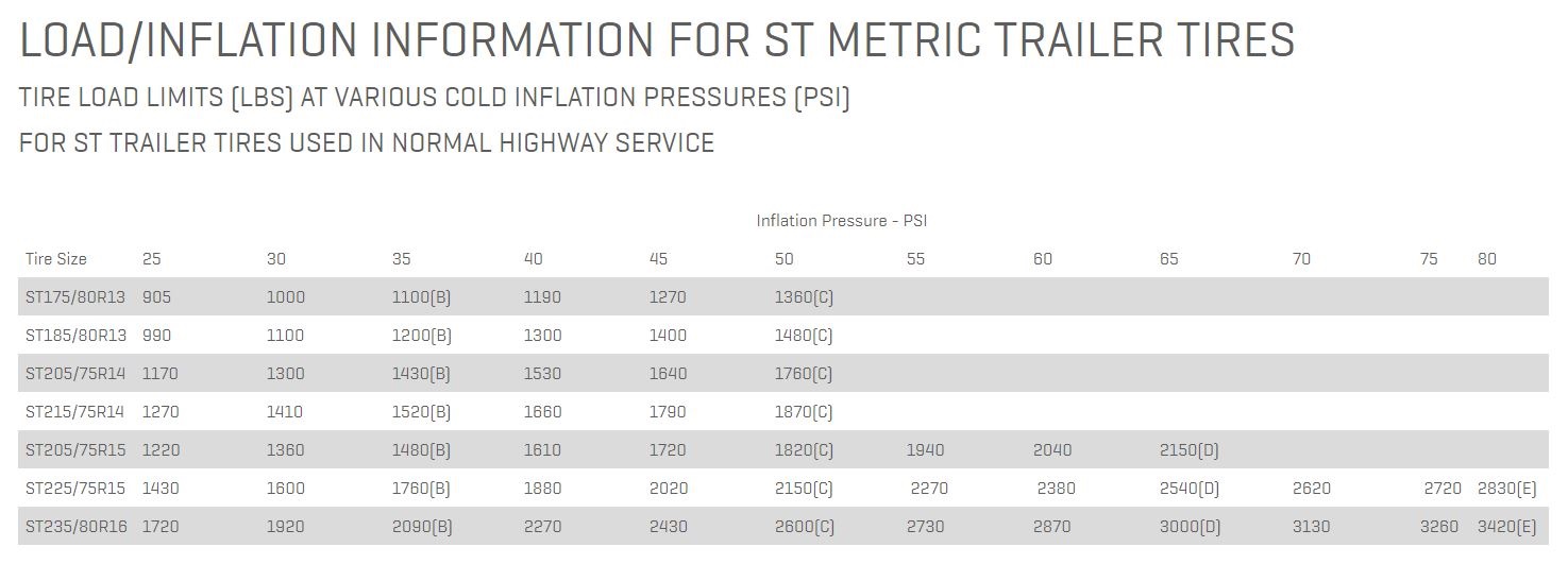

  • My set-up is a bit heavier, and I use specifically designed additions to eliminate bounce on my squareback TTT. I have a 3500 lb Dexter EZ Lube axle, non-cambered, with brakes, 3000 lb (combined) leaf springs, with an added active/progressive bumpstop/shock absorber system (always in contact with the axle), on 27 x 8.5-14LT General Grabber AT2 tires (@ the full recommended pressure of 50 psi). Weight of my trailer, fully loaded, is 1989 lbs, with everything but the kitchen sink (give me time...it's on my list); I DO carry more junk!
  • There is no bounce or sway (I use a single Weight Distributing spring-bar, adapted for use on my single-beam tongue, which provides lots of downforce on the tongue), which I attribute to the tires' construction (semi-flexible, tall sidewalls), the progressive shock absorbing action of the rubber bumpstop always acting upon any road imperfections, and the heavy tongue weight of 253 lbs (12.7% of total) with the addition of the WD-provided downforce.
  • I have used the full pressure on all my trailer tires for many years, when loaded, but I have have experienced bounce on my tandem-axled car-hauler (no shock absorbers at all), at those pressures, when lightly or completely unloaded. So, I think that the tire pressure needs adjusting downward from the recommended settings, only when there is a drastic reduction in the weight of the carried loads that the suspension & tires were designed for. I previously have reduced the pressure on my unloaded trailer's tires (ST 225/75-15) following this chart for ST tires, and the trailer didn't bounce, anymore. Your tire size is listed here, as well, so it may be of use to you, too.
    MAXXIS load vs inflation table for ST trailer tires.JPG (136.52 KiB) Viewed 2259 times

Postby hwitten » Sat Jun 02, 2018 9:51 pm
Thank you for the chart. Looks like I guessed reasonably close :)
Trailer parked for a while now so will be checking with manufacturer and dealer and any other sources I can find.
Might have to trade extra wear for comfort but that would be ok.

have used the 'tire PSI chart' posted here by -'working on it'- for years now with no problems when using trailer tires. With my old tear I ran them from 30/35 PSI (205-75Rx14)which weighted 1100 lbs loaded (the 50 PSI max printed on the side of the tire was just too much!!) (the last year I had it - it got an even "much" better ride when I replaced the trailer tires with regular car tires which YES I liked much better!!) Have now replaced the old tear with a new one and I stuck again with trailer tires - same tire size as the old tear - with this trailer weighting 1400 lbs loaded - am running the PSI about the same as I was before, 35 psi and it is doing fine so far. (and YES when these wear down far enough, this trailer will be getting car tires to replace them also!)
