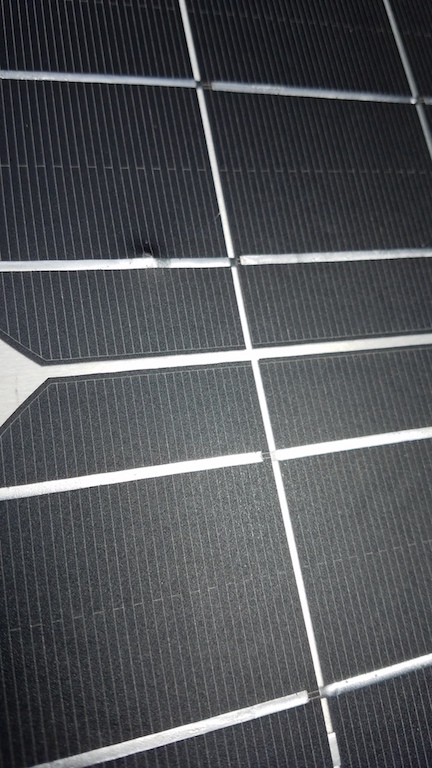

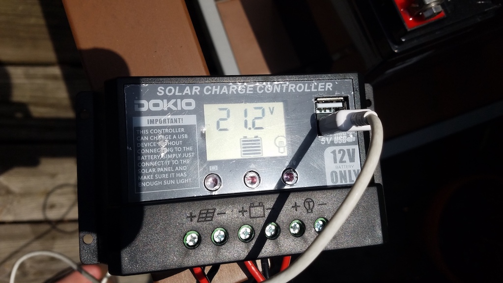

I purchased this off Amazon on Monday, as I wanted to try a lightweight 100w system with my 35aH battery. It was well packaged, 2 boxes, bubble wrap, filler paper, etc. Upon opening, notices a few compressions on the panel, a rub mark and the controller had a compression mark on the side of the LCD. I connected to the battery and everything seemed to work well, phone charging, etc.
I emailed and they asked if it worked, if so and wanted to keep, they'd partial refund. If not replace. Should I replace? I'm thinking yes, but wanted to have some insight from those familiar with

I would test the panel in full sun. Voltage test across the positive and negative. Then an amps test. See if it is putting out the power you paid for.
Next I would hook it to the battery so it is experiencing a load, and monitor (with my own meter) both the charge voltage and current.
I would check to see if the controller is indeed turning off the charge when the battery hits the target voltage.
I would do this even if the panel appeared to be in perfect condition

Return it and get a new one. Because it works today does not mean it will work tomorrow

I would do as Cosmo suggests, and test the panel. There is likely nothing wrong with it, but you certainly want to be sure. If it were already dimpled inside of the protective packaging, it got that way before packaging. So theres no guarantee the replacement won't be dimpled as well. It may be worth a note to the seller just to see what they have to say. I wouldn't be concerned about the dimple in the controller screen (performance wise) but the one on the panel may or may not be an issue. Looks like a nice little portable unit. Great start for going solar!

I returned the original, as it must have been prior to packaging. Refunded and sent a new one, arrived today.
It was packaged the same and no issues with this one. Definitely like the portability of a suitcase panel. The wiring is the crazy learning experience for me and I'm almost finished with my 12v system. I'll be trying it out this weekend. :thinking:

Those are supposed to be monocrystaline? new chemistry, or am i missing something? they don't look like mono panels to me.

Sorry so late in responding. I'm only able fo assume they are mono panels, not sure how to tell or find out. They have some flex but not made to bend so maybe that has something to do with how they look? Seem to work well from my 1 time use.

No problem. Just that those look like amorphous panels - which are usually much cheaper and not as long wearing. but, it is possible just your picture makes them look that way.
here's a good guide:
https://www.greenmatch.co.uk/blog/2015/ ... lar-panels
