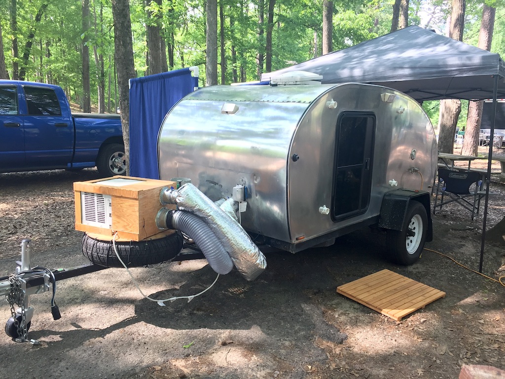

I did based on the HVAC hack thread above. I made a removal window insert for the duct connections.
My next step will be to make it so the inlet/outlet airstreams are more separated by either baffles, or just adding connections on opposite sides of the cabin.

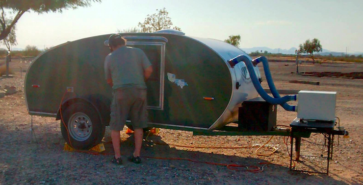

Here is John Millers from South Central group
Thomas

Sparksalot wrote:I did based on the HVAC hack thread above. I made a removal window insert for the duct connections.
152735
Thanks Sparksalot.. Is it worth cutting holes in your tear drop just to get them separated? I would guess for such a small area your window insert is adequate.
2bits wrote:Here is John Millers from South Central group
2bits wrote:and Brads
Thanks.. Looks like no one had to use a booster fan..
