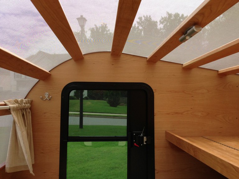

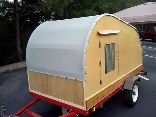

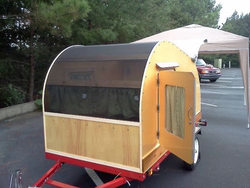

So I'm getting close to starting my build and I am gorging on all the information that I can find. Not only on this forum but everywhere else online. I ran across a site that a woman runs that talks about minivan camping. She had a special post about teardrops and she talked about a couple in Georgia that will build this teardrop for $2, 400. Trailer included. The original post is now 6 years old so who knows what the cost is now but even then it's hard to imagine they made much money.
My point of bringing this up and sharing the pictures is I really do love the design. I like the convertible top and the simplicity of using snaps to keep it attached. I don't know if it's possible to share a link so I will hold off on that but it said that the material is from a marine store so I'm assuming it would hold up in the weather.
I wrote to the person who builds and sells these to see if they would sell me the plans. I'm across the country in Washington State so buying one from them is really not in the cards. What are your initial thoughts about the design? Obviously with a convertible type top heat would be an issue but if someone installed a heater maybe things could stay relatively warm still on chilly nights?

I don't like the use of plastic for the entire top. You can see the wood roof spars through the cover! A stargazing window I can see but I'd be more worried about heat build up during the day.
I can believe they could make these for $2400. 4x8 HF trailer. No covering other than clear poly. Cheap hardware and windows. The trouble is it lacks details that make the trailer more usable and long lasting.

By plastic, I meant the plexiglass top which as you can see can't maintain it's shape without the wooden cross bars. The marine canvas cover would be nice for storage and travel, and it does eliminate any hatch leaks.

I might be mistaken but there is no plexiglass stop. There is a screened area underneath the cover. So if you remove the top cover you could do some stargazing but not get eaten up by mosquitoes LOL.

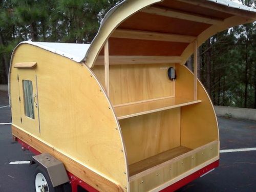

Here are some additional pictures some of other models. I'm completely flummoxed on how they attached the screen to the trailer and finished it off. But then again I'm not a carpenter guy although I did build a hot dog cart haha...
On this model they are only doing the Marine vinyl roof about halfway down. I like the look of the hatch here too.

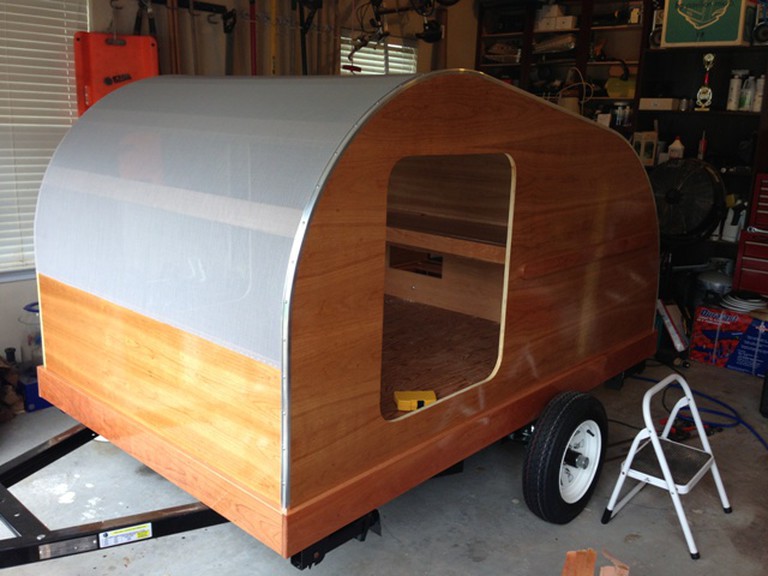

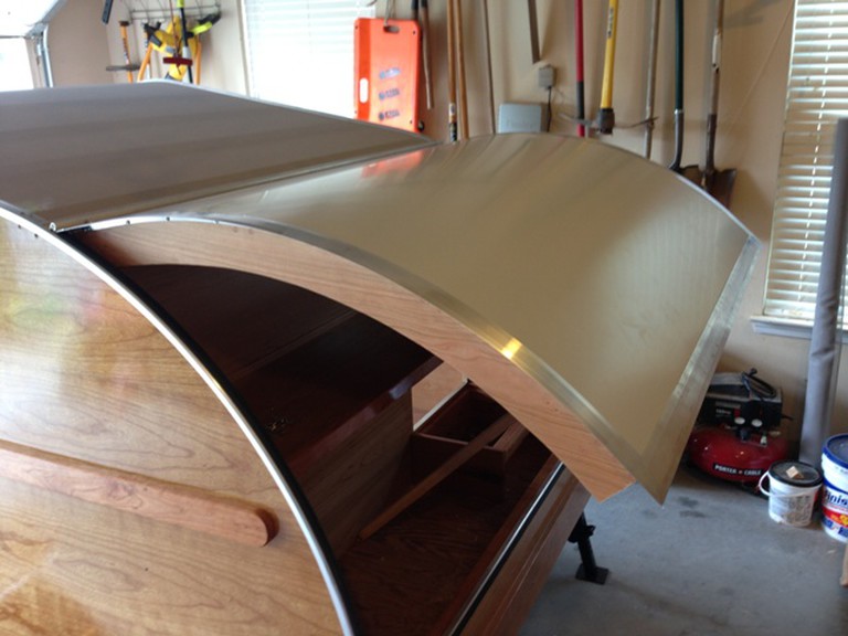

djdawg wrote:Here are some additional pictures some of other models. I'm completely flummoxed on how they attached the screen to the trailer and finished it off. But then again I'm not a carpenter guy although I did build a hot dog cart haha...
There are a few builds on here that are convertible types with screens. There is a member on here that built one who I think his name is snowbird? Perhaps he might pipe in. He also did another one called X Cubed? As far as keeping the screen in you can get flexible spline holders from big box stores and roll it in.

Screen would explain why the cross bars were visible under the cover. Plenty of ventilation on a clear night but you have to get up and out to put the cover on when it rains! I'd rather have something a little more weatherproof! Rode out some serious storms snug and dry in my foamie!
absolutsnwbrdr
173193172890148599
