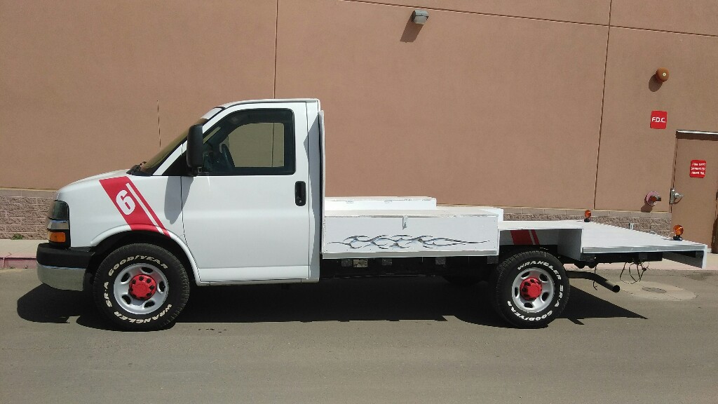

Ok, so I've got this.
Now what? :thinking:

7 ft tall walls on top of a bed that's already 3 ft off the ground? Maybe a lifting roof style to keep your driving height down.

@pmullen503 - the height was just an approximation at this stage. Yes, getting near 10' overall height but not different than today's slide ins, fifth wheel and class c. Point is taken though, how low to go?

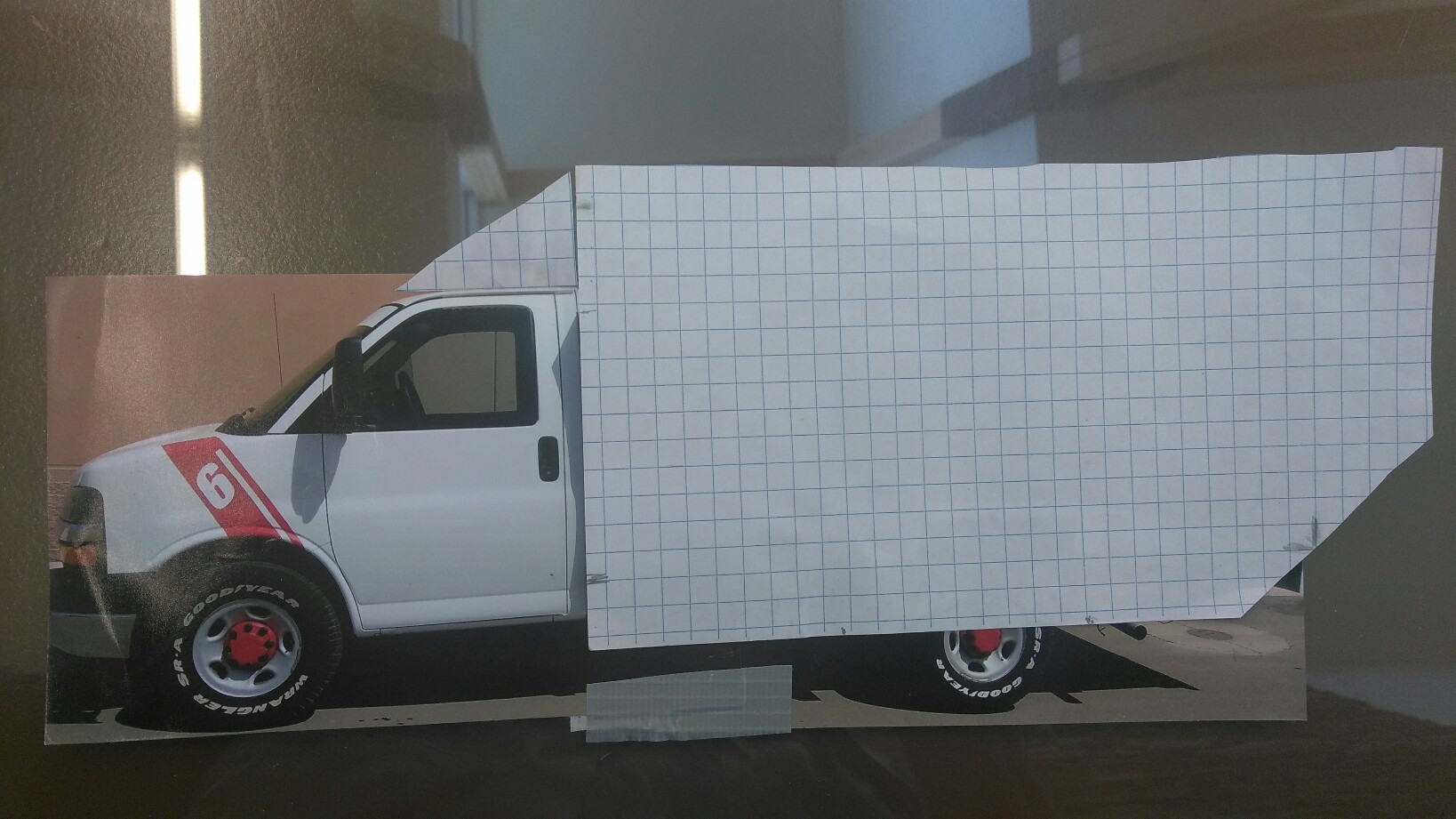

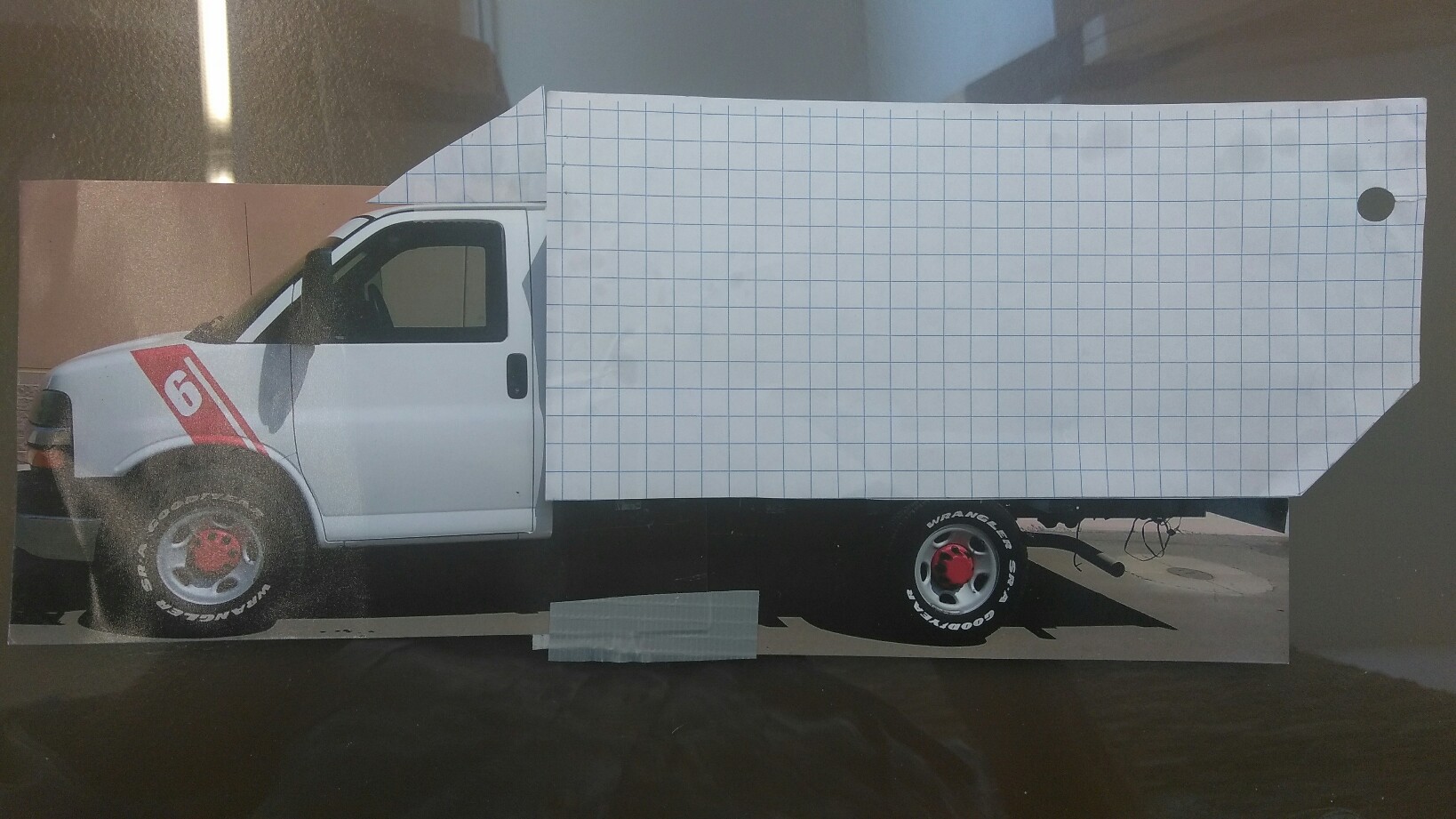

3. PMF Foamie with frame. Love the simplicity of this from an engineering and design standpoint but not so great on build time and method. How to properly lay the canvas on a 7*14 roof span with my short arm span and load bearing on the roof to do so? Possibly assemble roof and coat while on the ground and install in one preformed piece. As well, the cost to do so could be almost double in cost and time. XPS is $40 a 4*8 2" sheet here making it about $5.00/ft2.
Drew up a sketch to see if my proportions look reasonable. One is straight box, the other lowered sides like a lazy days to give a sleeker ground hugging look just for fun. Also give the option of below deck storage.

Why all squared off? Why not radius the whole roof and back?(a radius is a lot stronger) Slope up from the cab and round the back for air flow. By doing that(with 2" foam) you can get by with maybe three cross pipes under the roof. A 3/4 gap between the tubes and the roof make's for a great place to hang stuff.

Squared off for a couple reasons.
1. Simplicity of build and strength, torsion box
2. Style matches cab
3. Going for the overland expedition look. I call it overland lite. 8)
