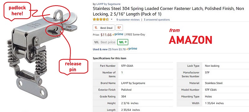

  • My 4x8 squareback TTT has a completely vertical, flat, 3/4" plywood hatch door (49.25" high x 48" wide) hanging from 3 gate hinges. As originally installed, there was a ever-so-slight gap between it and the edges of the sidewalls, roof, and the end of the trailer frame, and I used a small bulb seal (1/4") to seal that perimeter interface. The hatch was held closed by two Masterlock stainless flexible hasps, with padlocks attached. That worked fine for a couple of years, with the sturdy hinges preventing any lateral movement, and the hasps required some effort to compress the seal, and further insured a close-fit.
  • But later on, the hatch showed signs of slight warpage (<1/8") near the bottom, since there was no closure device near that area (the hinges at the top, and hasps located about 18" from the bottom, didn't exert enough pressure to hold the unsecured bottom snug against the seal). I fixed that problem with small right-angle stainless draw-latches added near the bottom of the hatch door.
    THE AD DESCRIPTION IS WRONG; THE LATCH LOCKS, AND HOLDS TIGHT UNTIL THE RELEASE PIN IS USED
    right-angle LOCKING latch.JPG (92.12 KiB) Viewed 1246 times

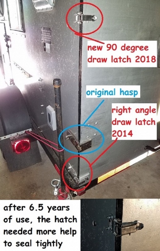

    working on it wrote:Mod # 2) After 6.5 years, my solid 3/4" plywood hatch is starting to show ever-so-slight signs of warpage, not really noticeable, but leaving gaps sealing it up. I started out with only a set of manual flexible hasps holding it shut, then added two right-angle draw-latches at the bottom sides a couple of years later. Now, four years further on, I added two more draw-latches (the same as the other ones) 16" from the top of the hatch. Now, there are no gaps when closed.
    third latch added to hold hatch tight.jpg (142.11 KiB) Viewed 1246 times
  • In retrospect, I should've never left a gap between hatch and the body of the trailer, and perhaps used used more equally-spaced draw latches (3 on each side) from the beginning, but I knew that the huge flat door would eventually need some attention eventually, so it was no big deal to retrofit it, later. As we all know, teardrops (and squareback TTT's) are never finished, but a work in progress....
