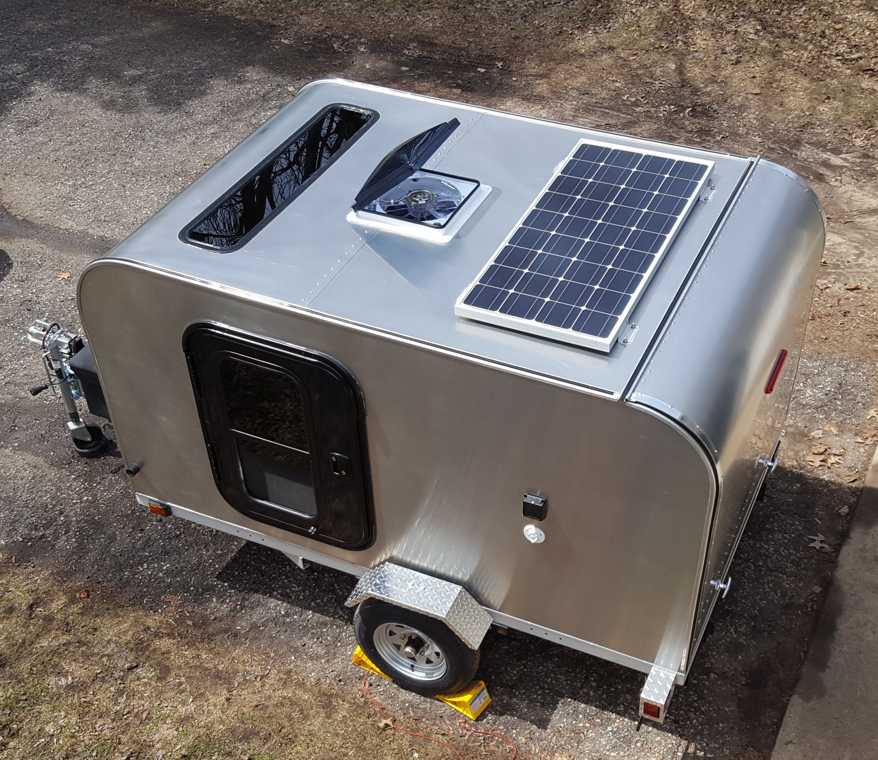

I have installed the window you are looking at from Vintage tech. I have the 45" x 9" Couple of things to note:
1. My window leaked around the rubber gasket that holds the window in. This has been noted by others on this forum. I used ProFlex RV Sealant to seal the gasket and it is now leak free.
2. There are 2 different trim rings. One is like 2 1/2 Inches and the other is 1 3/4 inches. How do I know? Yes, I had to purchase one of each after ordering the incorrect size. I was not informed about this at the time of purchase. Order the correct size for your wall(ceiling) width.
3. I agree about the added light into the camper, but...the summer sun really warms up the inside! Most of the time during the day I have Reflectix Insulation cut and fitted into the window to keep the sun out. It is bright as soon as the sun starts coming up( I don't mind this), but it might wake you up as others have commented about.
4. Condensation. Keep it as low as possible. We use our camper for 3 seasons. It will condensate and drip on you! Again, I use Reflectix and the fan to control the condensation.
5. Gets dirty and needs to be cleaned often.
6. Water puddles on my window. I wipe it off after a rain. Sealed tight with the ProFlex RV sealant.
7. No instructions on how to install window. I drilled pilot holes for the screws to hold the trim ring into the window.
I'm kinda on the fence if I would install another one in a teardrop. Advantages and disadvantages. I do like the light. Does need a little babysitting i.e. Covered up to keep sun out during day/wiping off puddling water/ cleaning glass

The idea is to have skylight in the forward area, a Fantastic Fan above the entry doors, and a 58" x 26" 160 watt solar panel mounted flat on the rearward flat part of the roof. The partially curved galley lid will be the rear end.
:thinking: Figuring out the best/optimal spacing is a little tricky & still up in the air.
My teardrop plan is to have a Benroy(ish) profile. (Maybe) it will have a 24" curved transition area from the front wall to the flat roof. It will be 5'4" wide and 10'1" long. The hatch design is not finalized and very subject to change. The Galley lid may be circular, or oval, shaped then flatten at the bottom.
:thinking: I'm trying to decide whether or not to mount the skylight/Stargazer window on the top of the roof. My design preference is to mount the skylight/Stargazer window in the front curved area. That may complicate construction. It would reduce spacing constraints. It might provide a nicer/better, somewhat private view toward the front and toward the sky too. Maybe it'd let in less solar heat, depending on which way the teardrop faces the sun while camping.

I'm favoring installing a Stargazer window in the (Benroyish) curved transition area between the front wall and the roof. The front curved area will be 64" wide and (probably) have a 24" radius curvature. The wall/curved area/roof will be 1-3/4" thick. I'd also buy the 1-13/16" trim ring to install the Stargazer window
:thinking: I wonder how easy, or difficult, it will be to construct the window opening, then install and properly water and weather seal a Stargazer window in the 24" curved area?
A Google search for Stargazer window images shows helpful examples for how it's been done.
(Potentially) installing a Stargazer window in the front curved area helps provide adequate room on the flat roof area for a Fantastic Fan and a solar panel which are important features.
