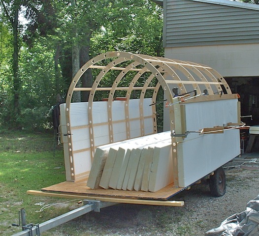

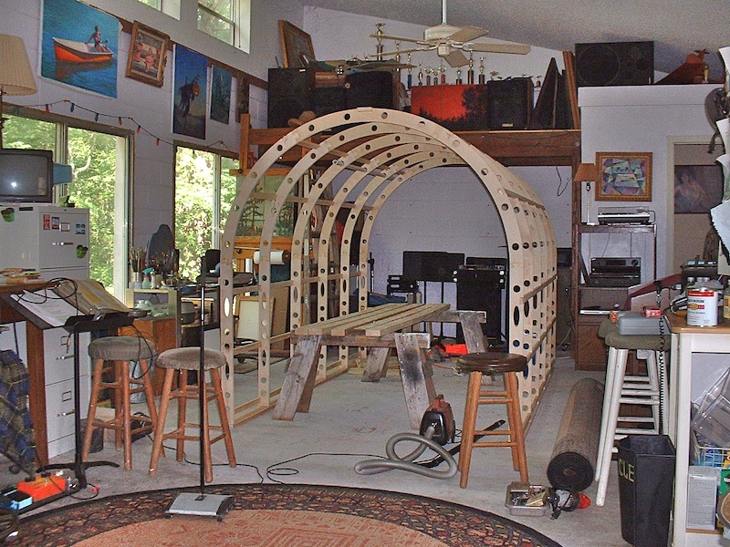

Postby noseoil » Wed Sep 19, 2018 7:05 am
The 3/4" skeletonized plywood wall is what I did as well & it's fine. I cut out a bit more of the wood than Tony did, but it's still plenty strong & has stood up to everything we have done so far. We used 1/8" baltic birch inner & outer walls, with 3/4" foam insulation in the voids. As was mentioned, the skins are what really strengthen this type of build. The 3/4" material serves to keep the skins separated so when they're glued in place, it acts like a "trussed" type of structure & the layers of skin & frame become a solid panel which is light & very strong.
Don't use 2x4's unless you have a semi truck for a tow vehicle, it's a waste of material, weight, time & money!
