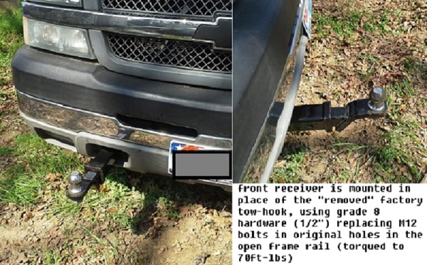

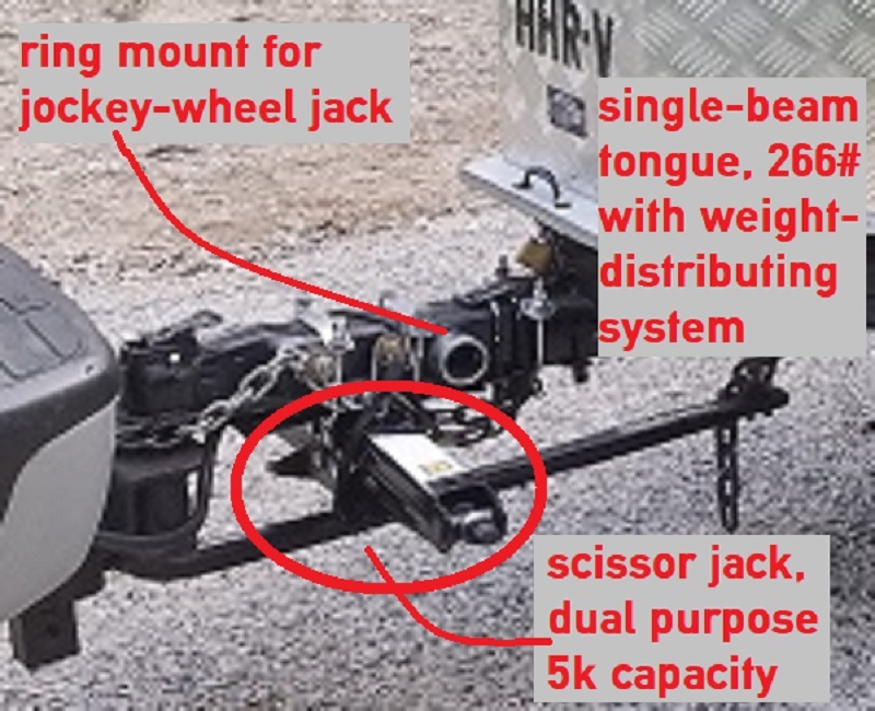

  • Maneuvering my squareback 4x8 into its' garage bay wasn't hard at first, with an under 100 lb tongue weight, while my knees and back were in better shape than now, 5-6 years ago. But things have changed. I considered buying a motorized trailer valet to solve the problem of stowing the TTT in the garage, but once again, I cobbled-together my own solution, not wanting to spend $300+ on a valet.
  • My TTT tongue weighs 260+ lbs, so I can't lift it (or even slide the sand foot along on the ground) by myself, so I installed an 8" solid rubber caster wheel (swiveling) on my existing removable jack, in order to be able to turn it around in my mixed-surface (sand, gravel, road-base) driveway. I had already made a front receiver for my truck, using which I can then push the trailer "back and to the left" (quoted from the movie "JFK") into its' garage bay. Otherwise, I'd have to make an acute-angle turn to back the trailer in from the narrow crowned road, then another 100+ feet up my driveway, make a 90 degree turn, and finally back another 75 feet downhill. Much easier to drive straight in, and unhook, then back the truck past the trailer, and re-hook after turning the trailer.
  • Since the added wheel made the jack too tall to install when unhooking, I added a sideways-mounted scissor jack to the tongue, to easily lift the tongue high enough for jack insertion onto its' pipe ring mount. The total cost for all the added parts was under $100, and takes me about 20-30 minutes to complete the operation, but I no longer have to get help from my wife or neighbor to swing the trailer around in the driveway, and to spot me when transitioning into the small 7'x7' bay opening. The front hitch on the TV is offset to the right, so I only have to line-up one side, for proper placement.
  • 154322 jack became too tall after adding swivel wheel, making scissor jack addition necessary
    tongue jacks & WD System.jpg (188.17 KiB) Viewed 867 times
    WD spring-bar is removed prior to stowing-in-garage procedure
    front receiver re-engineered.jpg (123.3 KiB) Viewed 867 times
    $10 part, offset-mounting for better sight-line
