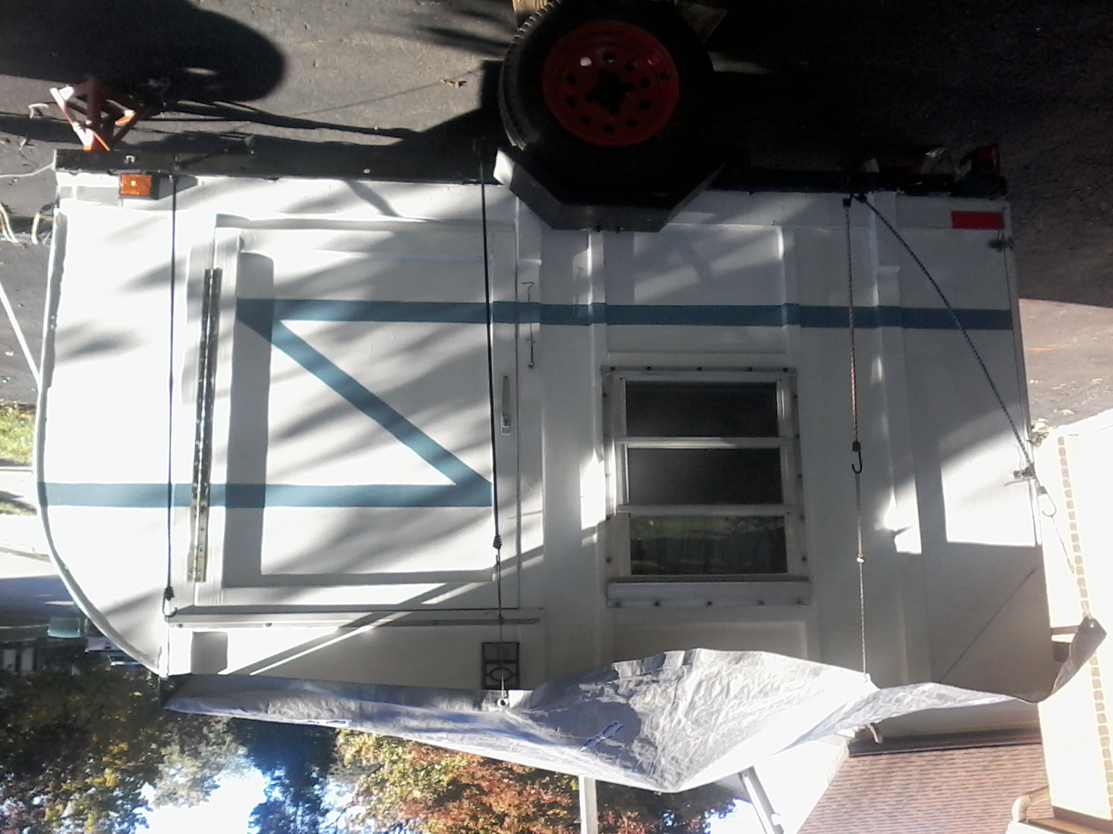

My camper sits outside so I should throw a tarp over it all winter for protection. I found some 1/2 " p v c pipe my wife had cut and saved. I used these across the camper roof and tied at each grommet. The tarp extends slightly over each side because of the pipe and when bungeed down the pipes bend in a nice curve. Easier to put on the tarp by myself also.

The problem I had with a tarp is it had water puddling due to lack of slope. Moisture was trapped where the tarp laid flat on the roof. I used an old deflated basket ball on the metal vent top to give the tarp some slope. Nice air space under the tarp. The P V C pipe under the tarp bends in a nice curve when bungeed. I've got both now and it's working out very well.

Geez, that's a lot better than my sad tarp. But on the plus side, it held up in strong wind and rain hasn't got under it.
Turn head 180 degrees. :-(

Hey, Tom! It looks like the gravity well in your area has a problem. :NC :lol:

I'm thinking he's on the other side of the earth. Madagascar maybe. :thinking: Everything is upside down there.

I guess you guys didn't read the instructions.
Yeah, if I knew how to flip the image I would have done that. It looked okay when I took the pic.
